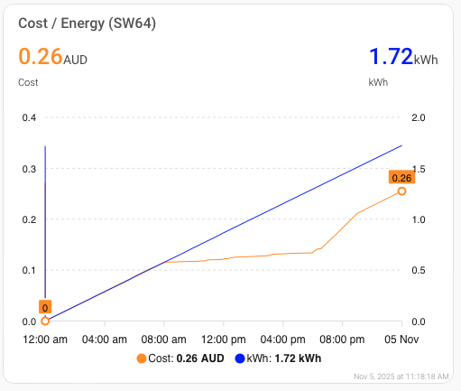

In my case I have solar, grid charges for Peak and Off Peak, and grid ‘rewards’ for Solar Export. I calculate some key device costs mainly from ESPHome code, with some help from Home Assistant and house solar, grid import/export measurements.
To give a simple example, I have a device that consumes around 73watts continuously. Here is a graph for cost accumulation yesterday.
The flat orange line is sun shine power, the steep section is Peak power
In simple terms, the logic is:

And here is a graph of the calculated ‘current cost of energy’
