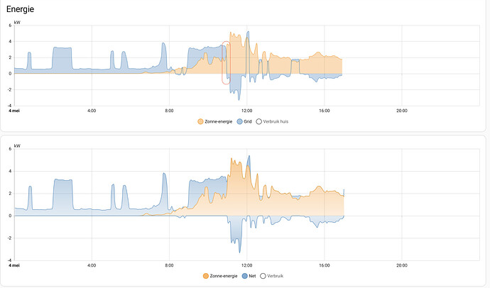

Any idea how to remove the blue lines in the solar fill (as it’s done in the stock power-sources-graph card)?
And is there a way to use a gradient fill instead of a solid fill (as in the stock power-sources-graph card)?
Custom card is on top.
Bottom is the power-sources-graph.

I’m not sure what’s exactly going on here.
Normally, you should see mixed fills when areas are drawn with fill 0.5 in front of each other like that:
But I see that you are using a stack, which normally should draw them on top of each other.
So I don’t get why the signals are crossing at all.
If I understand your signals correctly, I guess you wouldn’t need stacking?
Maybe this is a bug with calculated signals and stacks.
Could you try to remove the stack names, so the 2 signals (solar and grid) are drawn independently?
About the gradients: This isn’t possible so far, but I’ve seen your feature request on Github.
Will try to add that in a future release.
