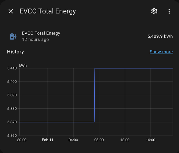

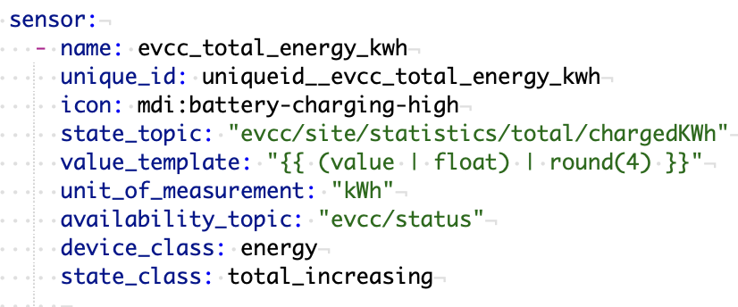

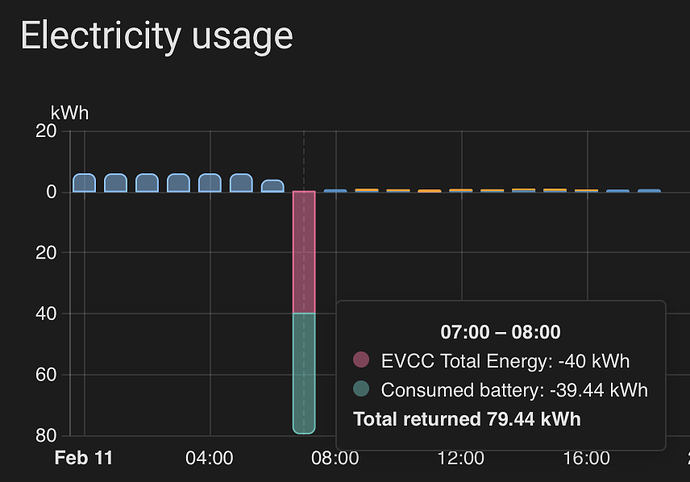

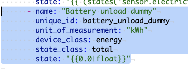

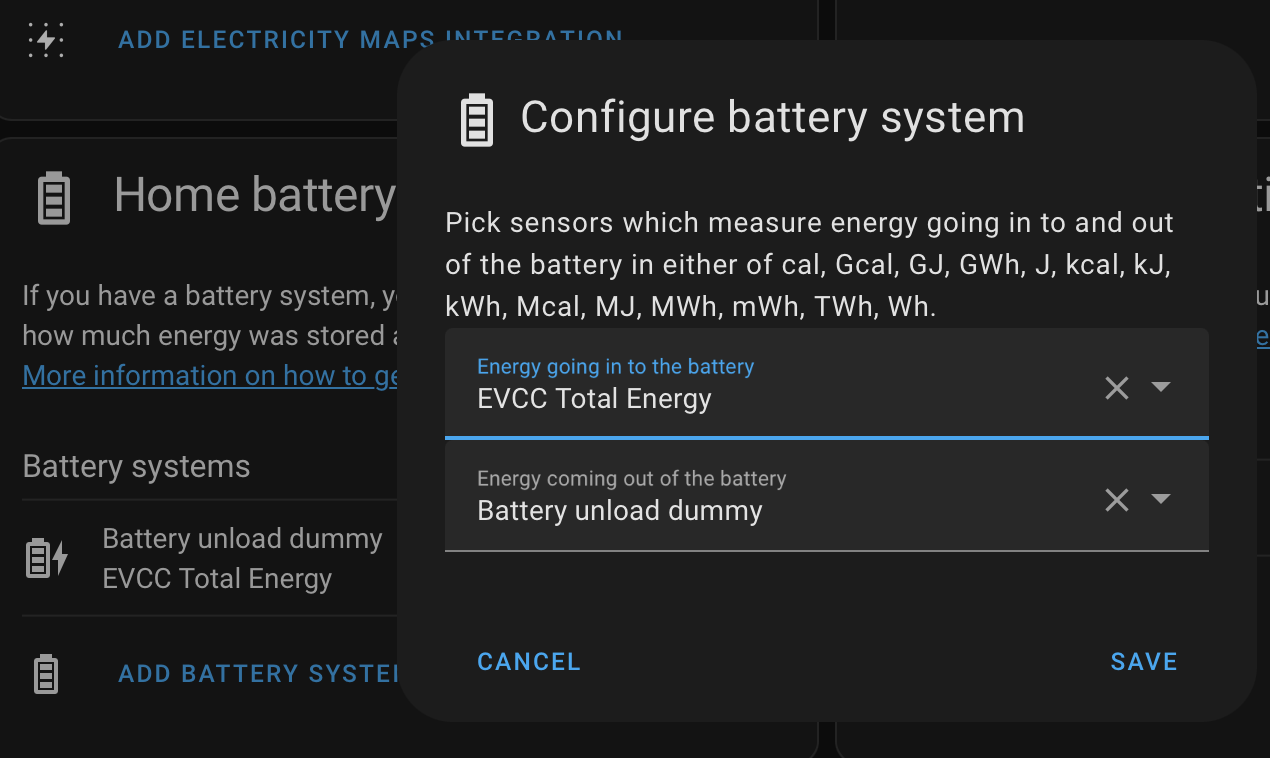

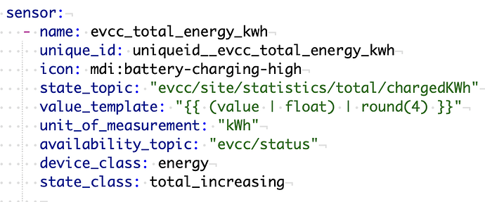

I’ve followed instructions for adding a dummy unload value for the battery and I have a total kwh from evcc, but somehow in the energy dashboard it shows both ‘consumed battery’ and ‘evcc total energy’? anyone have a tip?
Screenshot 2025-02-11 at 19.43.52

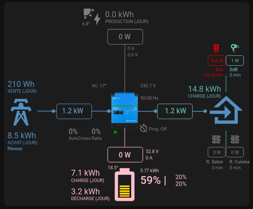

i will love this option too, but something more generic :
Home Assistant should re-use the concept of Essential Load in custom:sunsynk-power-flow-card :
It’s configurable (max 6):

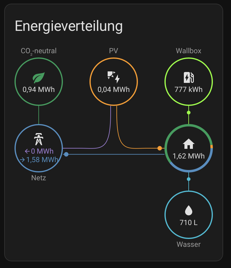

How did you configure HA to get the car in the energy dashboard like in your screenshot?
Using your gas implementation (great idea!) as a foundation, I optimized that idea a bit by building a custom js-script with Geminis help to modify the frontend a bit.
Adding this in your configuration.yaml:
frontend:
  extra_module_url:
    - /local/fix-energy-text.js
and this as a new file called fix-energy-text.js in /config/www/:
(function() {
  const translations = {
    'Gas': 'Wallbox',
    'Gasverbrauch': 'Wallbox-Ladung'
  const pathEV = "M19.77,7.23L19.78,7.22L16.06,3.5L15,4.56L17.11,6.67C16.17,7.03 15.5,7.93 15.5,9A2.5,2.5 0 0,0 18,11.5C18.36,11.5 18.69,11.42 19,11.29V18.5A1,1 0 0,1 18,19.5A1,1 0 0,1 17,18.5V14A2,2 0 0,0 15,12H14V5A2,2 0 0,0 12,3H6A2,2 0 0,0 4,5V21H14V13.5H15.5V18.5A2.5,2.5 0 0,0 18,21A2.5,2.5 0 0,0 20.5,18.5V9C20.5,8.31 20.22,7.68 19.77,7.23M18,10A1,1 0 0,1 17,9A1,1 0 0,1 18,8A1,1 0 0,1 19,9A1,1 0 0,1 18,10M8,18V13.5H6L10,6V11H12L8,18Z";
  const colorChartreuse = "#7FFF00";
  const colorChartreuseAlpha = "rgba(127, 255, 0, 0.5)";
  function processNode(node) {
    // 1. Texte (global)
    if (node.nodeType === Node.TEXT_NODE) {
      for (const [oldText, newText] of Object.entries(translations)) {
        if (node.nodeValue.includes(oldText)) {
          node.nodeValue = node.nodeValue.replace(new RegExp(oldText, 'g'), newText);
    if (node.nodeType === Node.ELEMENT_NODE) {
      // 2. CSS Variablen für Charts
      if (node.tagName === 'HA-PANEL-ENERGY') {
        node.style.setProperty('--energy-gas-color', colorChartreuse);
        node.style.setProperty('--state-gas-color', colorChartreuse);
      // 3. ICON-PFADE & ANIMATION (Suche über den Pfad-Inhalt als Anker)
      if (node.tagName === 'path') {
        const d = node.getAttribute('d') || "";
        // Check A: Ist es die Flamme? (Identifikation über Pfad-Anfang)
        if (d.startsWith("M17.66")) {
          // Wir prüfen, ob dieser Pfad in einem "gas" Container liegt (DOM-Tree hochwandern)
          if (node.closest('.gas') || node.getRootNode().host?.closest('.gas')) {
            node.setAttribute('d', pathEV);
        // Check B: Ist es die Animations-Schiene?
        if (node.id === 'gas' || d === "M40 0 v30" || d === "M40 0v30") {
          node.setAttribute('d', "M40 30 v-30");
          node.style.stroke = colorChartreuse;
      // 4. FARBEN (Tabellen & Kreise)
      // Kreis-Container einfärben
      if (node.classList && node.classList.contains('gas')) {
        if (node.classList.contains('circle-container') || node.classList.contains('circle')) {
          node.style.color = colorChartreuse;
          node.style.borderColor = colorChartreuse;
        // Animations-Punkt umfärben
        if (node.tagName === 'circle') {
          node.style.fill = colorChartreuse;
      // Tabellen-Balken über Hex-Code identifizieren
      const styleAttrib = node.getAttribute('style') || "";
      if (styleAttrib.toLowerCase().includes('8e021b')) {
        node.style.backgroundColor = styleAttrib.includes('7f') ? colorChartreuseAlpha : colorChartreuse;
      // 5. Shadow-DOM Untersuchung
      if (node.shadowRoot) {
        processShadow(node.shadowRoot);
    node.childNodes.forEach(processNode);
  function processShadow(root) {
    processNode(root);
    if (!root._observed) {
      const observer = new MutationObserver(() => processNode(root));
      observer.observe(root, { childList: true, subtree: true });
      root._observed = true;
  setInterval(() => processNode(document.body), 1500);
you can get an Energy Card that looks like this:
Of course you have to make it work with your language by replacing the “Gas” and “Gasverbrauch” with whatever it says in the dashboard in your language and with whatever you want it to say instead of “Wallbox” and “Wallboxverbrauch”. As long as there’s no 1st party way, I’m pretty happy with that workaround!
After saving the file, you have to restart HA and hard reload (without caches!) the website for the changes to apply!
