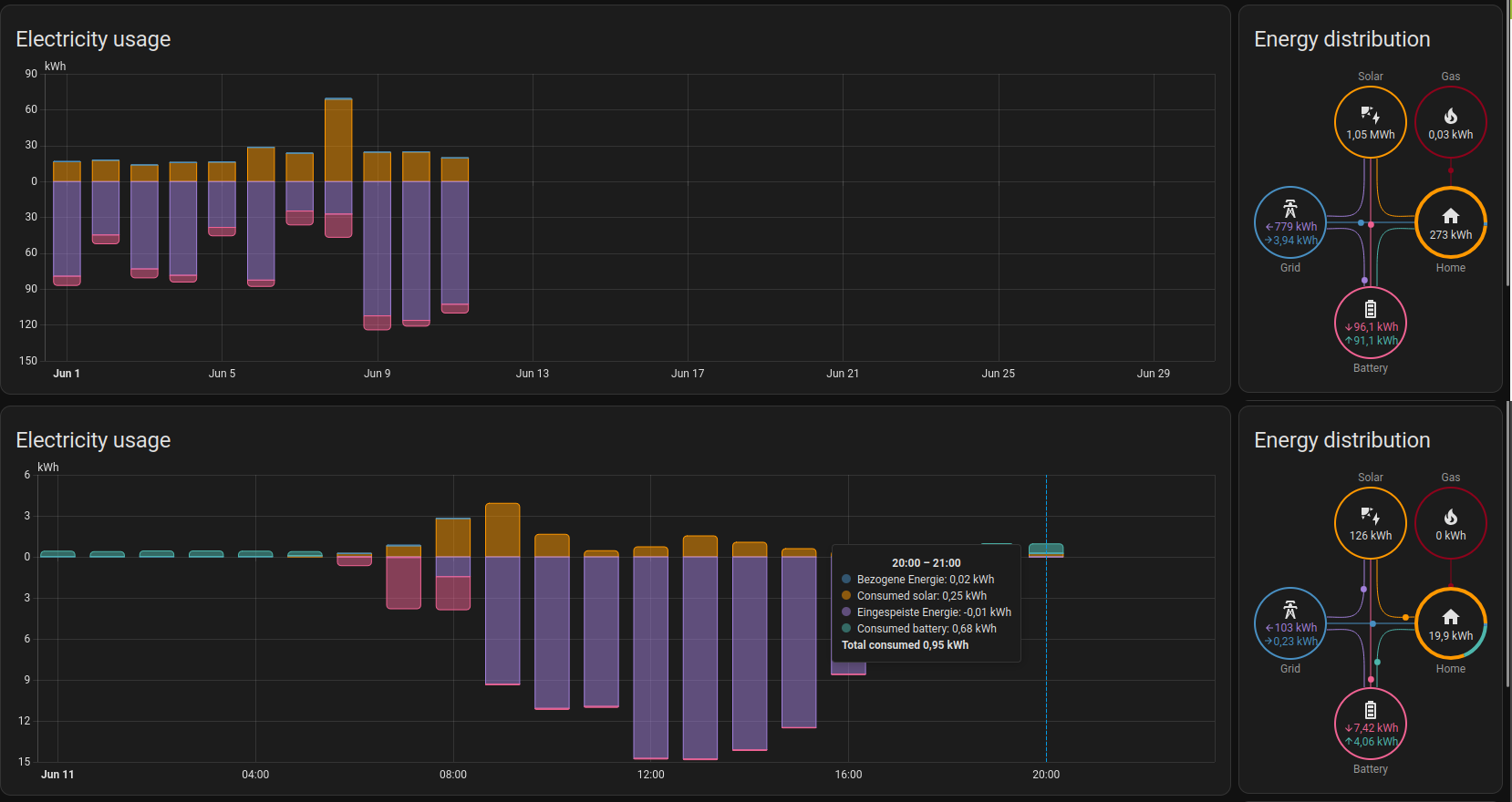

The monthly view on energy consumption in the Energy Dashboard does not include the consumption from the battery for me.
It does show up in the energy flow bubble of the battery, but not in the consumption of the home.
Does anybody know, what I did wrong?
Statistics seem to be there, otherwise the bubble would be empty and it would not appear correctly for the daily stats.
I’ve got the same problem, maybe I can specify.
On my 3 systems with a Fronius inverter and a BYD battery system all the daily views are displayed correctly. If I switch to monthly or yearly they are displayed without the battery information on 2 of the 3. I’m pretty sure they were right some months ago and I found out that it could be wrong since the 2025.4 update. This update changed some energy dashboard behaviour.
Interestingly one of this 3 systems is still correct overall - the system has the “energy” sensor configured via the GUI helper function. The 2 wrong systems have a nearly identical configuration but via yaml.
