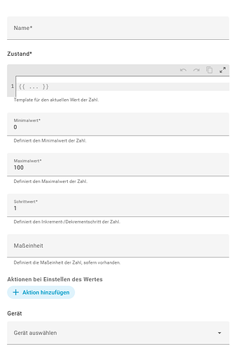

The helper has those settings:
because i don´t have this options:
That isn’t the template helper.
ok i am in devices → helper → new → template. what will be the correct way?
Settings → Devices & Services → Helpers tab → + Create Helper button → Template → Sensor
