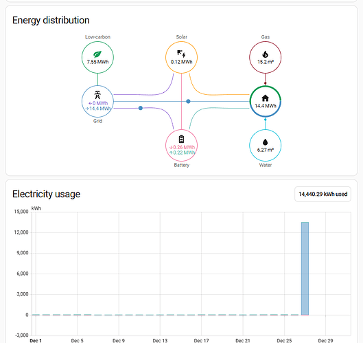

My Homewizard P1 meter went offline for some time. This meter is integrated in the energy dashboard of Home Assistant and worked fine (up till now). After it came back online its actual value is seen as the power input for today, thus ruining my dashboard. Is there any way to solve this? See the screenshot below.

Go to the history panel and select that sensor. Share the history graph for the time the problem occurred.
