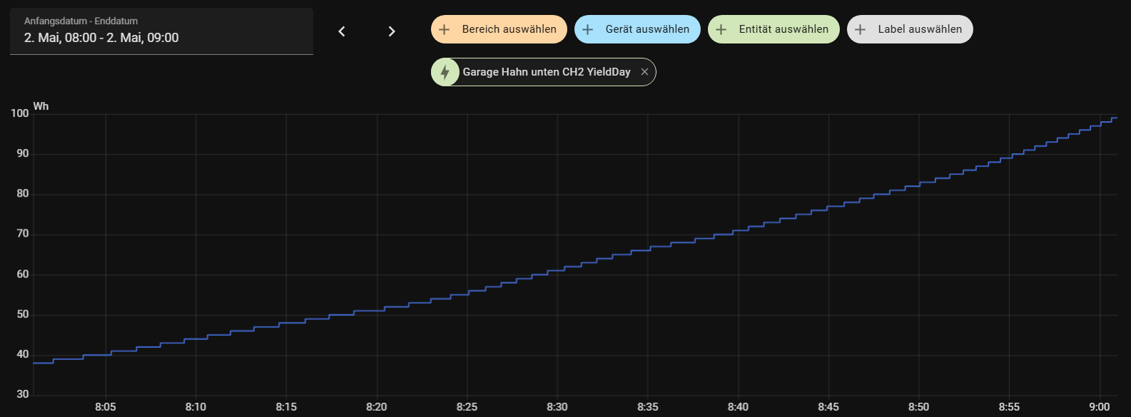

  • On 02 May 2025 (a day with detailed status data), the Ch2 YieldDay entity has increased by 61 Wh according to the history from 08:00 to 09:00. The Energy Dashboard shows a value of 0.06 kWh for the same period. So it fits.

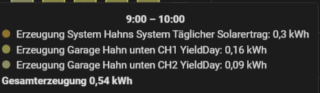

  • On 16 April 2025 (a day with only long-term statistics data), the Ch2 YieldDay entity has increased by 85 Wh according to the history from 08:00 to 09:00, but the Energy Dashboard only shows 0.04 kWh for the same period, which does not fit, as 85 Wh would actually be 0.085 kWh (rounded up to 0.09 kWh).
Where does the 0.04 come from?
  • If you look at the history again, you can see that the Ch2 Yield Day entity increased by 41 Wh from 07:00 to 08:00 - which corresponds to exactly 0.04 kWh .
The 0.085 kWh (0.09 rounded up) then only appears from 09:00 to 10:00 in the Energy Dashboard.

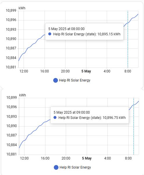

Here is the plot for the exact same sensor, with values captured only at the hour.
You will see that at 08:00 the state value is 10895.15, and at 09:00 the value is 10896.75
These are correct.
The slight difference (10895.16 and 10895.15) is because the Statistics Integration captures the values at the exact hour, and I took my value at the first state value after the hour. What I should have done is take the last state value of the preceding hour. The difference is negligible, hence the solar graph still works.
The big difference is that the long-term state value is recorded for 08:00. Hence the ‘apparent’ time shift of one hour.

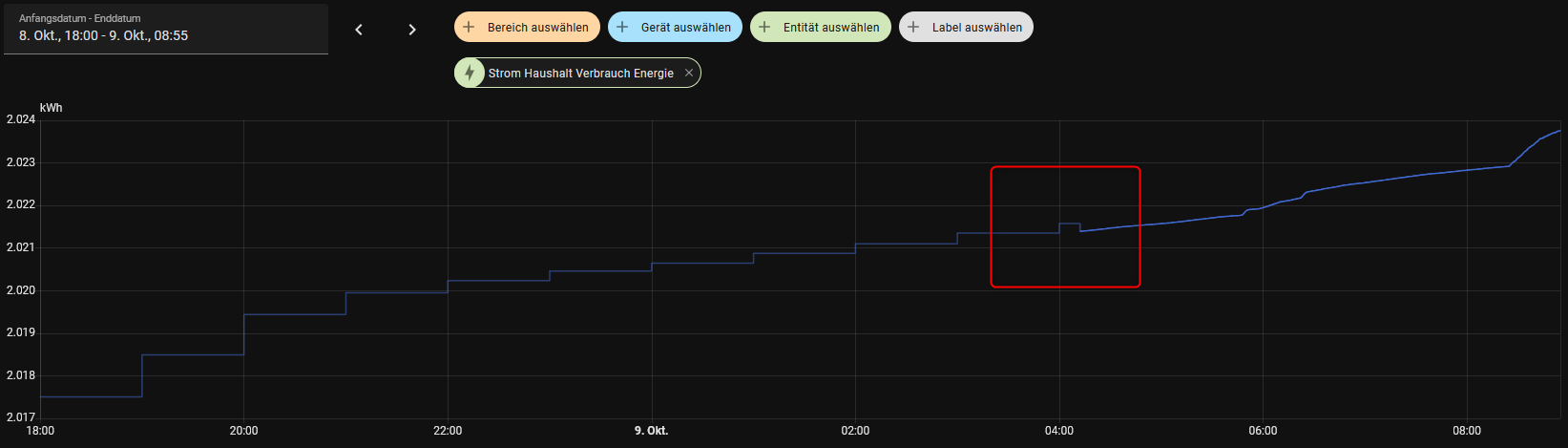

But just looking at the history graph itself I see a problem:
The graph shows the total energy with state_class: total_increasing.
  • Normal history: The values from the house energy meter are displayed with the correct time. This is as expected
  • Long term history: The values are shifted by -1 hour. this is not as expected. Independent how the values are stored in the long term statistic itself, if it is displayed in the history graph they should show the value at the right time? Because everybody would interpret the values from the history graph as displayed and don’t expect any offset.

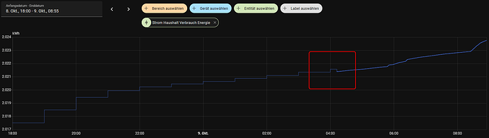

Here another example:
(I’m not allowed to post two pictures)
Here again the energy with state_class: total_increasing
I think everybody would be confused why the total energy counts backwards.
In the last days I calculated how much energy I need in the night so estimate the correct size of the battery for photovoltaik. There I would have done a wrong estimation, because I didn’t know that the history graph has an offset by 1 hour if it goes to the long term statistics.
For me this is bug, what is your opinion?
