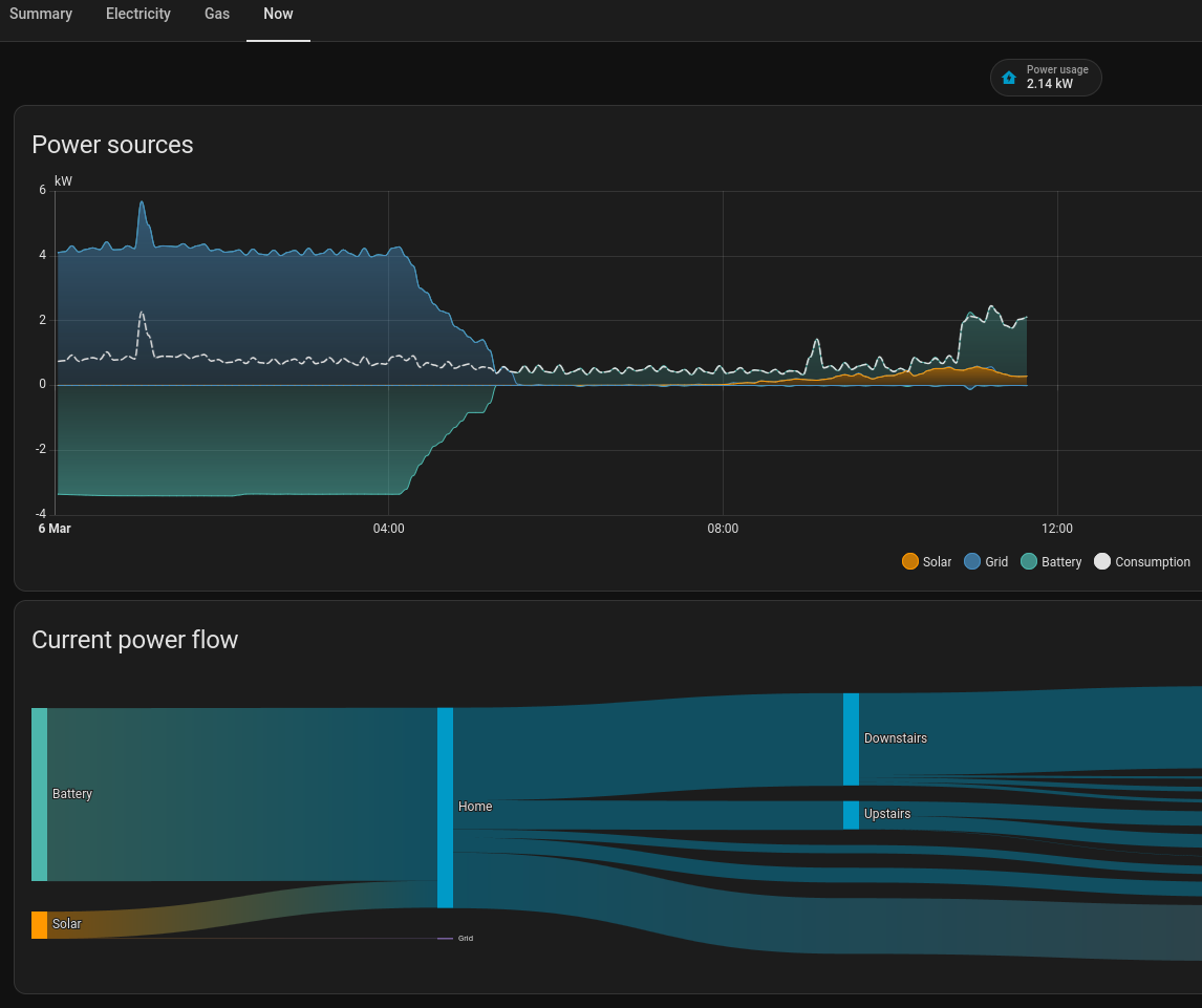

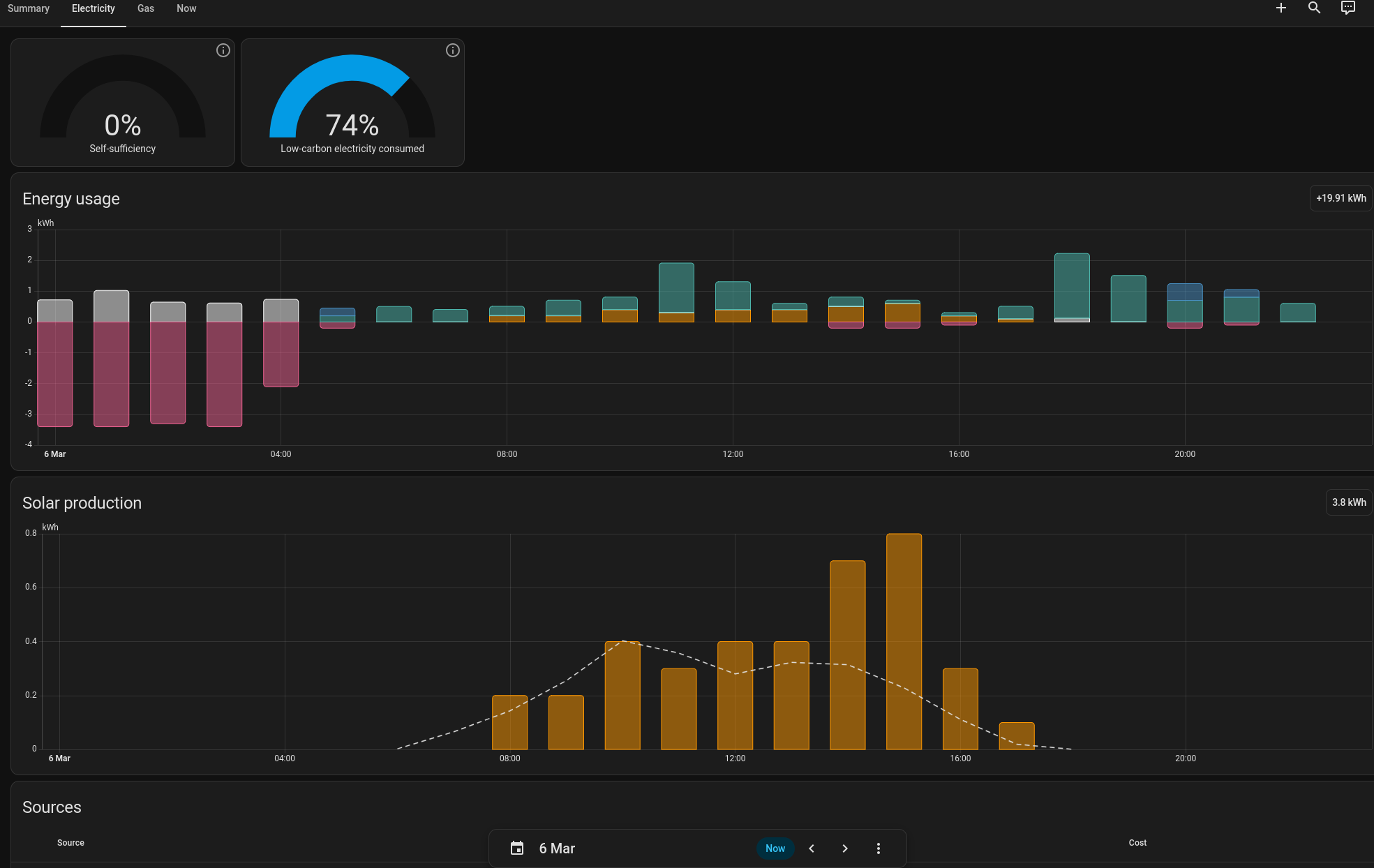

Energy dashboard missing "Now" view in dashboard
Since the new energy dashboard in version 2026.3 should have some new realtime badges for energy consumption. I decided to check it out. Seems that my dashboard is missing the “Now” view/button. Anyone else has the same problem? Do I need to activate it somewhere?
Have you configured all the sensors correctly in the dashboard for grid, individual devices etc?
Mine looks ok:

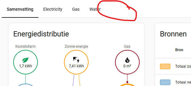

I’m even missing the distribution card now…
I don’t have the now or the summary tab, I only have an electricity tab
Looks like quite a few issues with this update, I’m missing net consumed grid and self consumed solar badges.

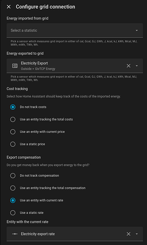

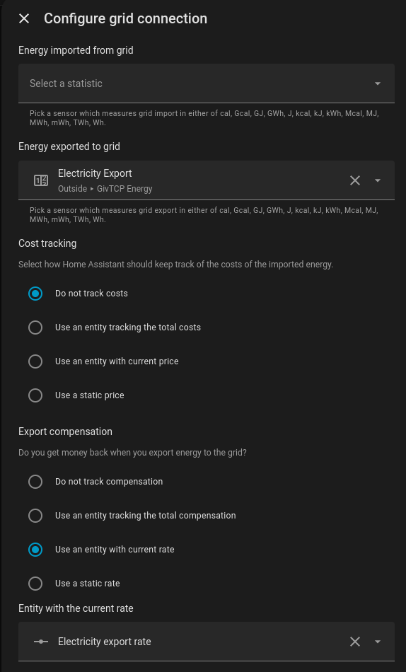

I managed to get the summary and now display to show by going back into the energy configurations and changing the type of power management from no power management to a sensor, then they both appeared.

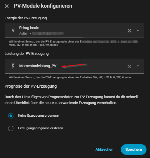

I had the same problem. my solution was to place the entity for the actual watts:
i assume that this entity is empty for you?
If you’re missing a tab and you think it should be there, can you copy the energy diagnostic json downloaded from the upper right corner of the config/energy page?
Also make sure you do the normal cache clearing after an update as well.
This is what I had to do to make the Summary and Now tabs appear.

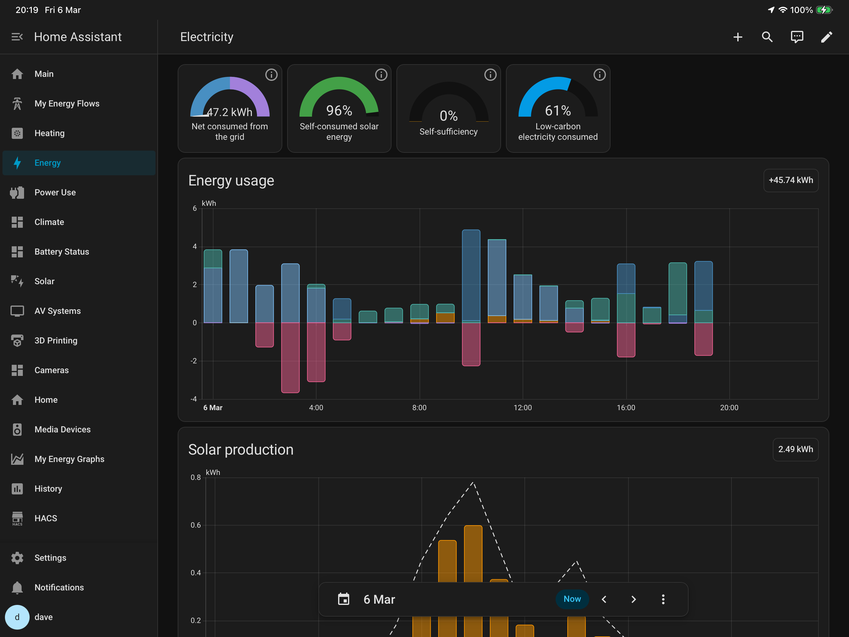

Any idea why I am missing net consumed from grid and self consumed solar as per my prior post?
Also my energy distribution is not showing solar to grid?

@fireplex You don’t seem to have any grid export configured. Net consumed from grid and self consumed solar only appear when you have grid export. This is not a new rule.
@MindFreeze But I do have it configured:
and I can see export reported in my “Now” view when I’m exporting.
My bad. I missed it in your config. I see the bug now. Will fix it.

Already tried to clear the browsers cache. How can I post the “energy diagnostic json” as an attachment because can’t paste it into this form because number of lines to reply is limited. The json exceeds the line limit of this forum.
I cut out the data from my individual devices to fit in the line limit
Thanks, much appreciated
This is my json
  "version": "2026.3.1",
