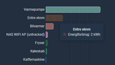

Hi
Is it possible to see cost price on entitys ?
(I have cost sensor on my main supply)
