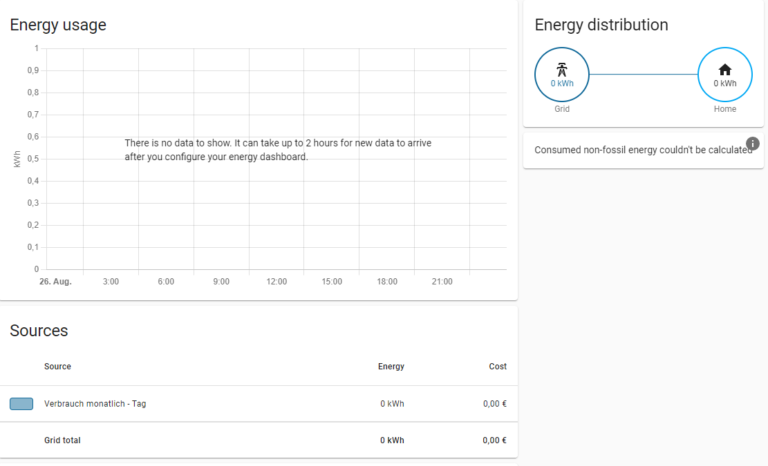

Energy Dashboard remains in initial state
I have a sensor in HA, showing the electric power sonsumption (kWh). This sensor feeds a utility_meter (monthly), and the utility meter is registered in the Energy Dashboard.
This is running now for more than 2 days, but the Energy Dashboard is still in the initial state.
Has anybody a hint what I can do, to make the Energy Dashboard start counting?
