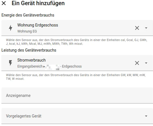

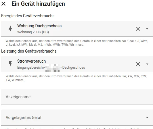

All devices configured under “Individual electric devices” in the
Energy Dashboard with no “Upstream device” set for any of them.

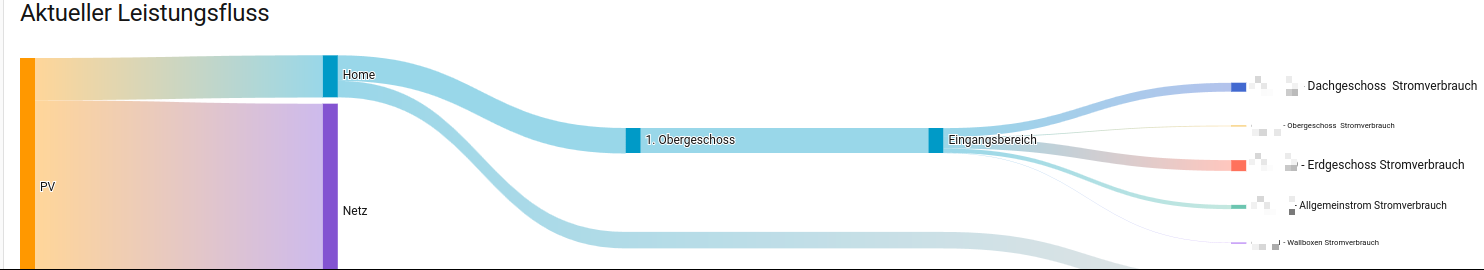

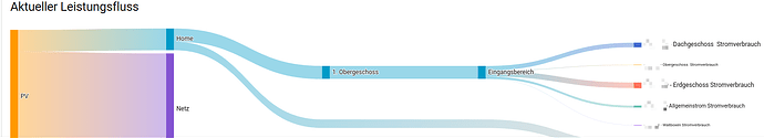

Actual behavior
One apartment meter (“1. Obergeschoss / OG”) appears as an
intermediate node, with all other consumers incorrectly routed
through it:
PV ──┐
├──→ Home ──→ 1. Obergeschoss ──→ Apartment EG
Grid ┘ ──→ Apartment DG
──→ Common electricity
──→ EV charging

  • “Upstream device” field is empty for all configured devices
  • The power sensors use the smart-me internal device hierarchy
    (Eingangsbereich → sub-device), which HA may interpret as a
    physical hierarchy
