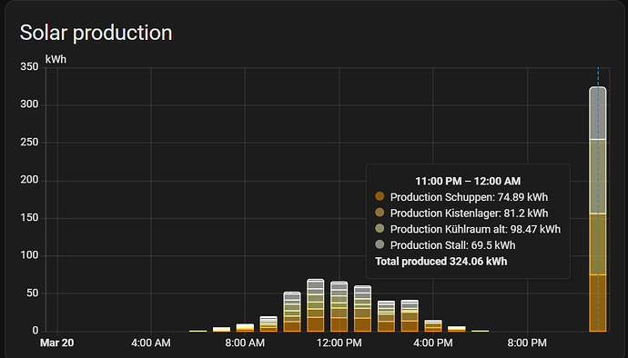

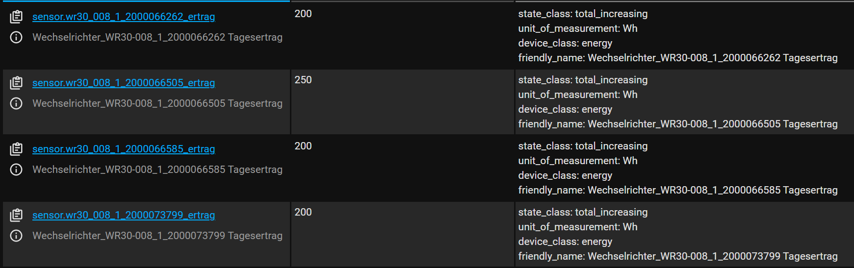

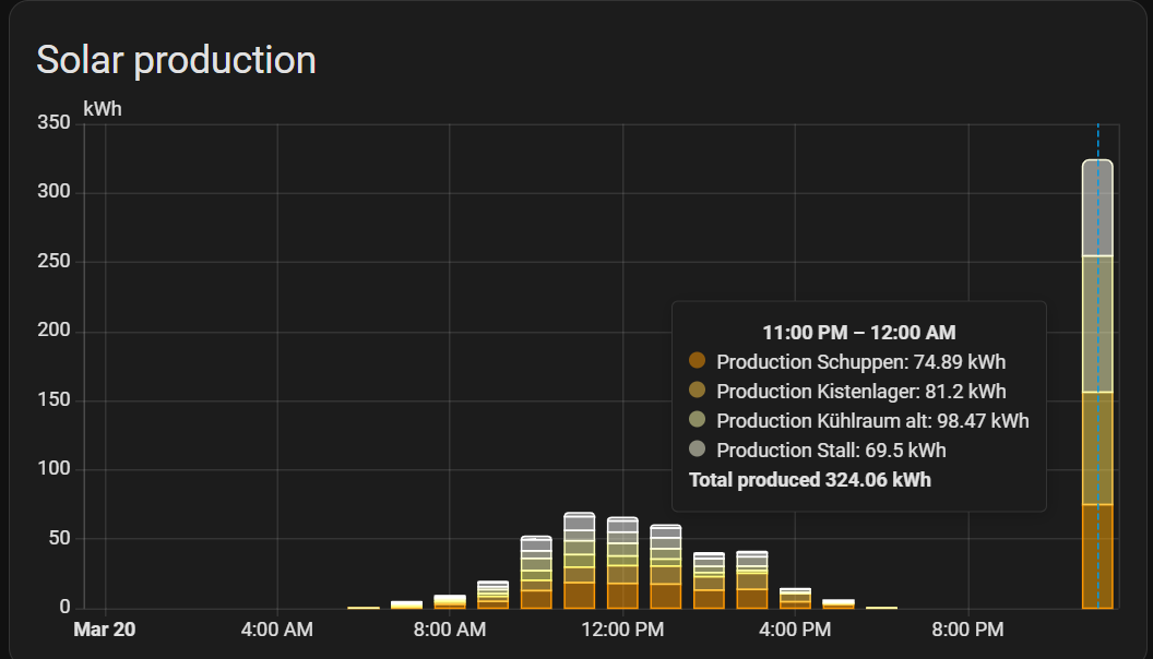

I’m encountering a similar issue where my solar production data appears glitched Solar Production. However, all my sensors are configured with state_class: total_increasing.

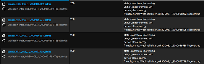

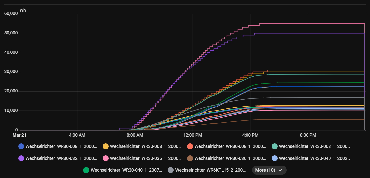

I have 7 different solar plants, each consisting of a different number of inverters. Each inverter drops slightly before midnight back to zero Inverter History.

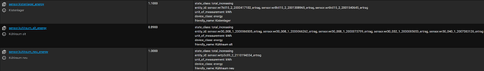

But each inverter sensor is marked as state_class: total_increasing, as shown in Sensor States.

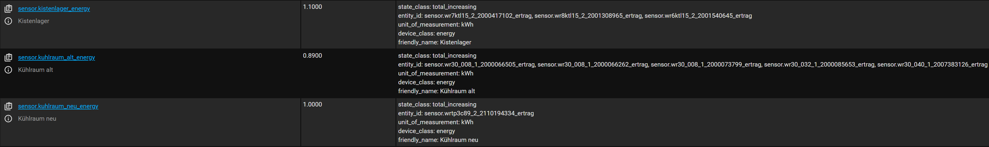

To aggregate the data per plant, I have created helpers that sum up the inverters of each plant Helper States.
These helper entities are then used in the Home Assistant Energy Dashboard.

  • As seen in Solar production, only 4 out of the 7 plants are affected by the glitch, even though all sensors are configured with state_class: total_increasing.
  • The problem likely starts earlier, as the individual sensors already reset to zero, which should not happen with state_class: total_increasing.

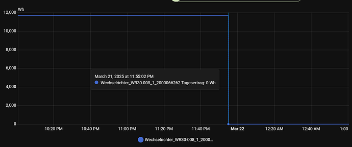

This is in the CSV file from one sensor:
entity_id,state,last_changed
sensor.wr30_008_1_2000066262_ertrag,11700,2025-03-21T21:00:37.377Z
sensor.wr30_008_1_2000066262_ertrag,0,2025-03-21T22:55:02.955Z
And here the history plot for the above csv file.
So all I get from that is that the data from the sensors is pretty clean. But I expacted them to be clean because I scrap them from the Webpage of a local Controller with node red. And due to the issue, I thought I can resolve it with a clean cut from the sensors over midnight, so I block the sensor readings between 23:55-00:05.

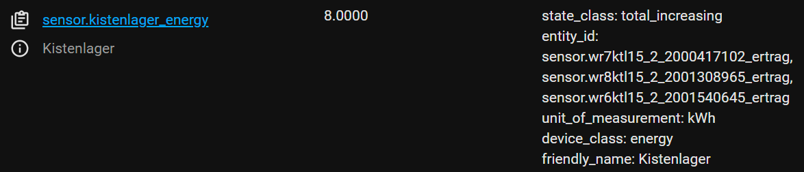

As mentioned earlier in my first post, I use a helper to sum multiple inverters together into a “plant.” For example, “Kistenlager” in the energy dashboard consists of:
sensor.wr7ktl15_2_2000417102_ertrag
sensor.wr8ktl15_2_2001308965_ertrag
sensor.wr6ktl15_2_2001540645_ertrag
When I checked the Kistenlager helper CSV, I found this, which is causing the issue:
sensor.kistenlager_energy,69.7000,2025-03-21T16:59:08.243Z
sensor.kistenlager_energy,47.2000,2025-03-21T22:55:02.973Z
sensor.kistenlager_energy,24.5000,2025-03-21T22:55:02.976Z
sensor.kistenlager_energy,0.0000,2025-03-21T22:55:02.982Z
The reason for this is that the individual inverter sensors are not perfectly synchronized when they reset to zero. This happens because I use a for loop in Node-RED.
sensor.wr7ktl15_2_2000417102_ertrag,0,2025-03-21T22:55:02.976Z
sensor.wr8ktl15_2_2001308965_ertrag,0,2025-03-21T22:55:02.980Z
sensor.wr6ktl15_2_2001540645_ertrag,0,2025-03-21T22:55:02.973Z
Is there a sensor option to ignore lower values (except for zero) when using state_class = total_increasing? Or is there another way to work around this issue?

If you know exactly when those sensors will reset, you put logic in your template sensor to force it to 0 before the first one resets, until after the last one has reset.
But yes you’ve correctly identified that there are synchronization issues to what you are doing.
Generally I don’t recommend mixing any energy sensors via templates, as it has problems like this.
