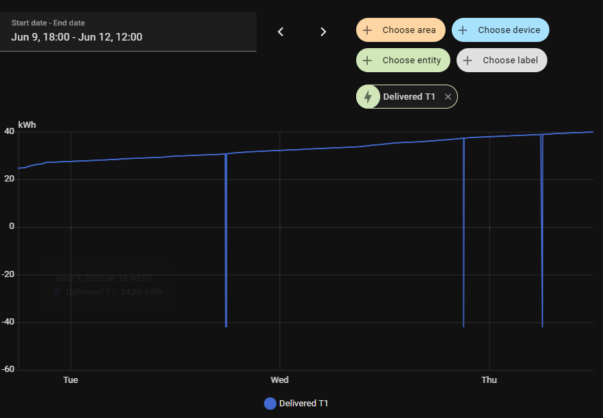

When I check the sensor, I notice the following:
Some dips occur at times of reboot of Home Assistant. 100% match.
I do not return power to the grid by any means.
Also did a test of rebooting the P1 dongle, it does not occur at that time.
Finally I also just did a test with rebooting Mosquitto, that incurs the dip, but not the calculation error (however the calculation might be done by the hour, so I have to wait another 25 min).
Yeah those dips are your problem. Every time they occur the full height of the spike is added to your energy total.

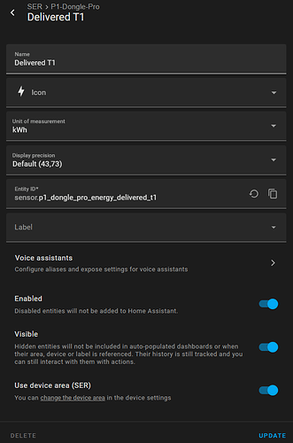

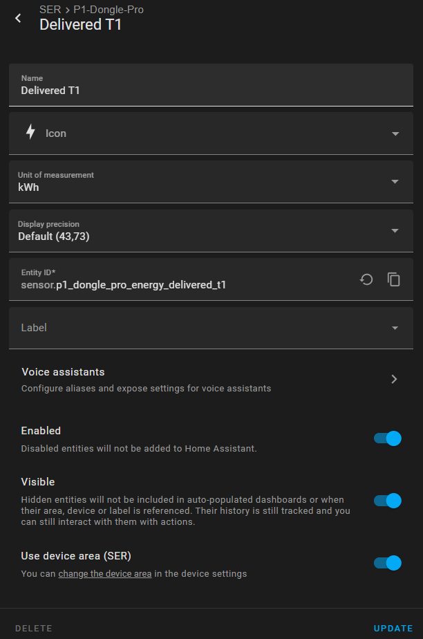

The Delivered T1 entity is this one:
