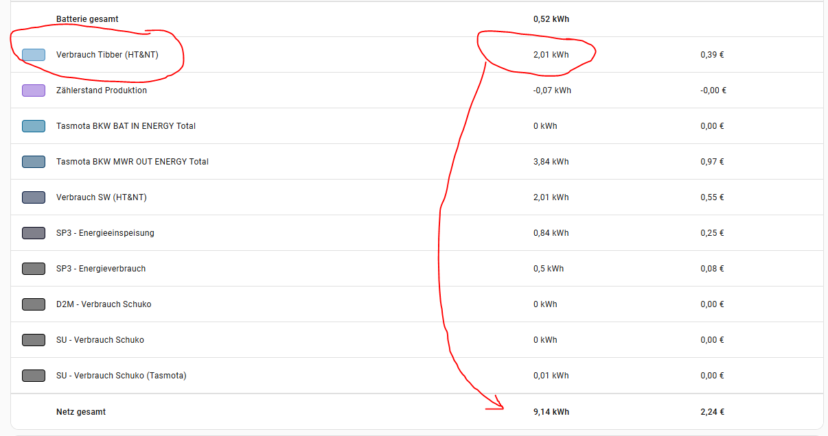

Enable the configuration of sub-consumers for network connections to prevent double counting of consumption. In the screenshot, the "Consumption Tibber (HT&NT)" network connection is the meter reading; all other values ​​are actually just consumption meters used to determine individual costs. Therefore, it would be desirable to be able to exclude the other network connections from the total consumption.

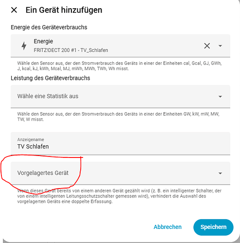

This function already exists for devices through the "Upstream Device" option.

I don't think it would be necessary to alter the long-term statistics themselves, but rather just the way the total grid consumption is calculated. If it were possible as is the case with individual devices to specify a sub-option, then it should be feasible to exclude these specific devices from the overall calculation, thereby avoiding double-counting.
In my view, all other alternatives for capturing consumption data including cost tracking and reliable statistics are unfortunately either extremely cumbersome or downright impossible to implement.
