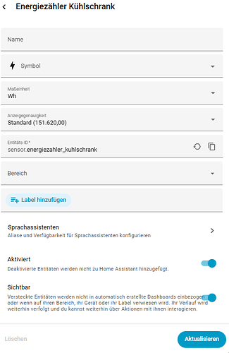

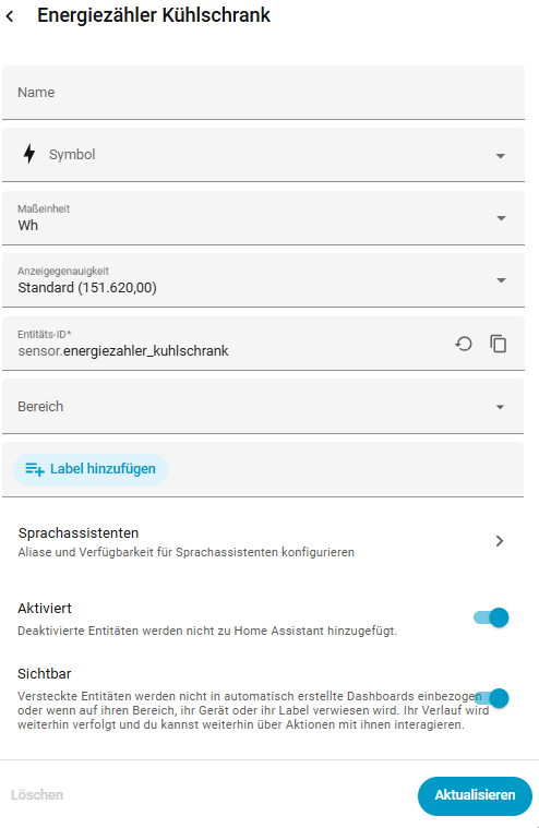

i just change it, the value increased in HA but the unit is still Wh:
Energiezähler Kühlschrank   151.620,00 Wh
The value is now correct. You should now use display as in the entity itself to set it to kWh. This is usually not necessary but since it was misconfigured before it tried to keep the Unit from before

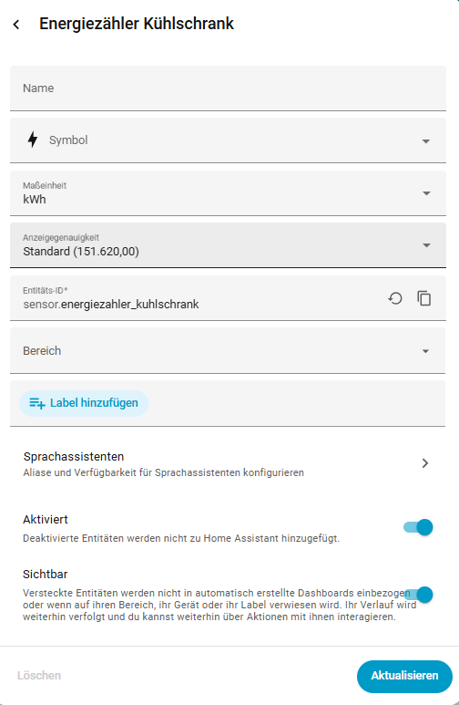

In the entity card I change the unit from Wh to kWh and apply but nothing happen. Unit is still in Wh.
Are you in the entity itself or the card on the Dashboard?

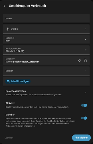

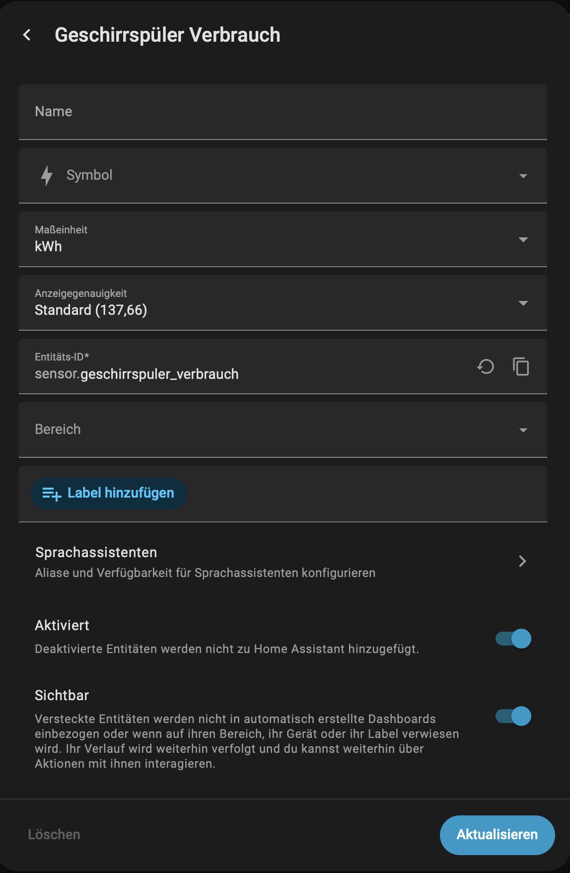

This is the Window you should have:
to
The unit is still in kWh after apply. Is there a way to force it?
Have you tried clearing the frontend cache?
cleared and even tryed a new/other browser. Still the same state, I can’t change the unit.
