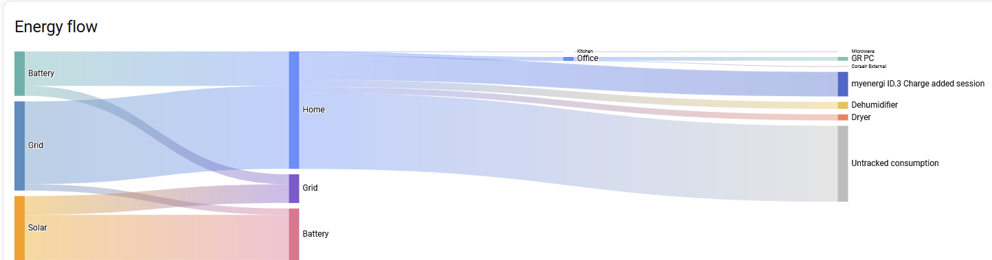

In the energy flow diagram I can see that my “GR PC” is connected to my “Office extension lead” and that it doesn’t double count the two values, it knows that one is the parent of the other.
I’m about to buy some energy monitors that will go into my fuseboard/consumer unit. This means practically everything in my house will be downstream from these sensors.
Can I configure something to say that “Dehumidifier” will be downstream from “Kitchen sockets” for example?

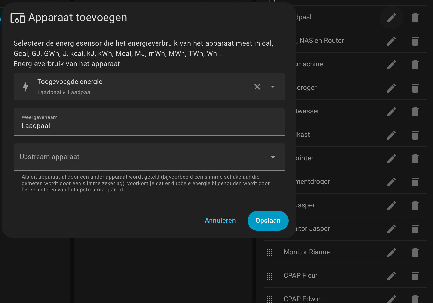

Yes. "You do it in the energy dashboard, when configuring individual power consumption entities.
Oh, you are a star. All these devices were installed before the flow update and I didn’t check the obvious place.
