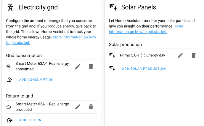

I have a fronius solar system.
I have in energy data panel selected the data sources but not sure If I have selected correct ones as the graphs dont appear correct compared to data I am seeing in the fronius app. Also the self consumption figure %age appears too low.

Seems ok to me.
Fronius shows instantaneous power in their app, whereas HA shows daily energy. The graphs look similar, but show very different data.
I’d use “Total Energy” for solar production - like stated in the documentation - to avoid issues from deviating clocks (eg. next day begins couple minutes / 1 hour earlier on one device).
