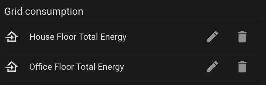

When I create the calculation helpers in the Grid I cannot link to them as upstream from individual devices.

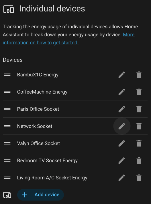

If I add the helpers in individual devices so I can link them as upstream from other devices and then add them to the grid I get exponentially wrong values.
How can I link the individual devices
to grid consumption
so I can deal with complicated meter plans the way I can do in the Grid entities?

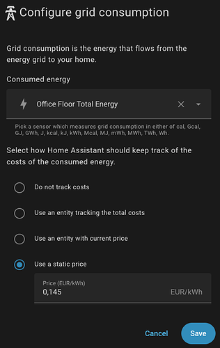

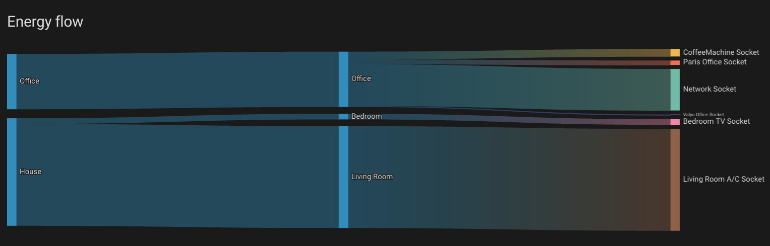

I want to be able to have the individual devices comsumption like this (works awesome)
but my summary is empty if I don’t add anything to the grid.
  1. How can I use individual devices consumption tracking and still have summary?
  2. How can I do cost estimation in this scenario?
