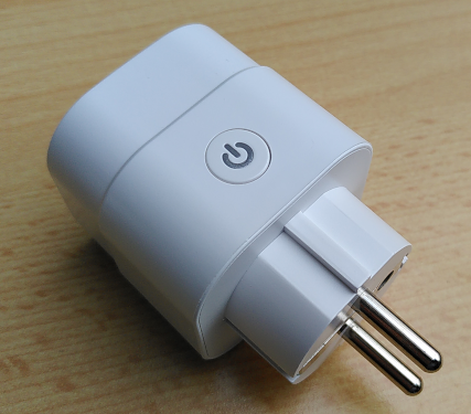

Thank you! I wouldn’t have guessed that the Athom plugs have no relay as the product picture looks like they have a button, but I think I’ll get a few of those first
Let us know how that goes.
There is definitively some kind of button, but it is not for controlling any relay (there is none
I think it is either for resetting the device or has no function at all and is just there to cut production costs because the no-relay-version is an adaption of the relay-version.

Update: The sockets arrived today. They announce themselves as ‘athom-without-relay’. I agree with Gunnar that they probably share the layout with another version.
The button on the side clearly suggests that it is used to turn the socket on and off. It’s not doing that, though. That’s probably a standards violation in many jurisdictions, so they would be unusable for anything official.
The button still has a purpose, long-pressing will factory-reset the device. It also blinks during setup.

Except for the mislabeled button I am pleased. Power measurement matches the Ikeas.
Edit: They use less space than the Ikea and may be a better fit in tight places
