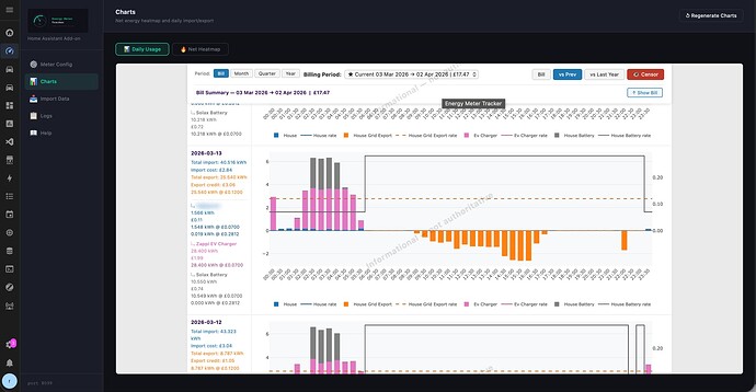

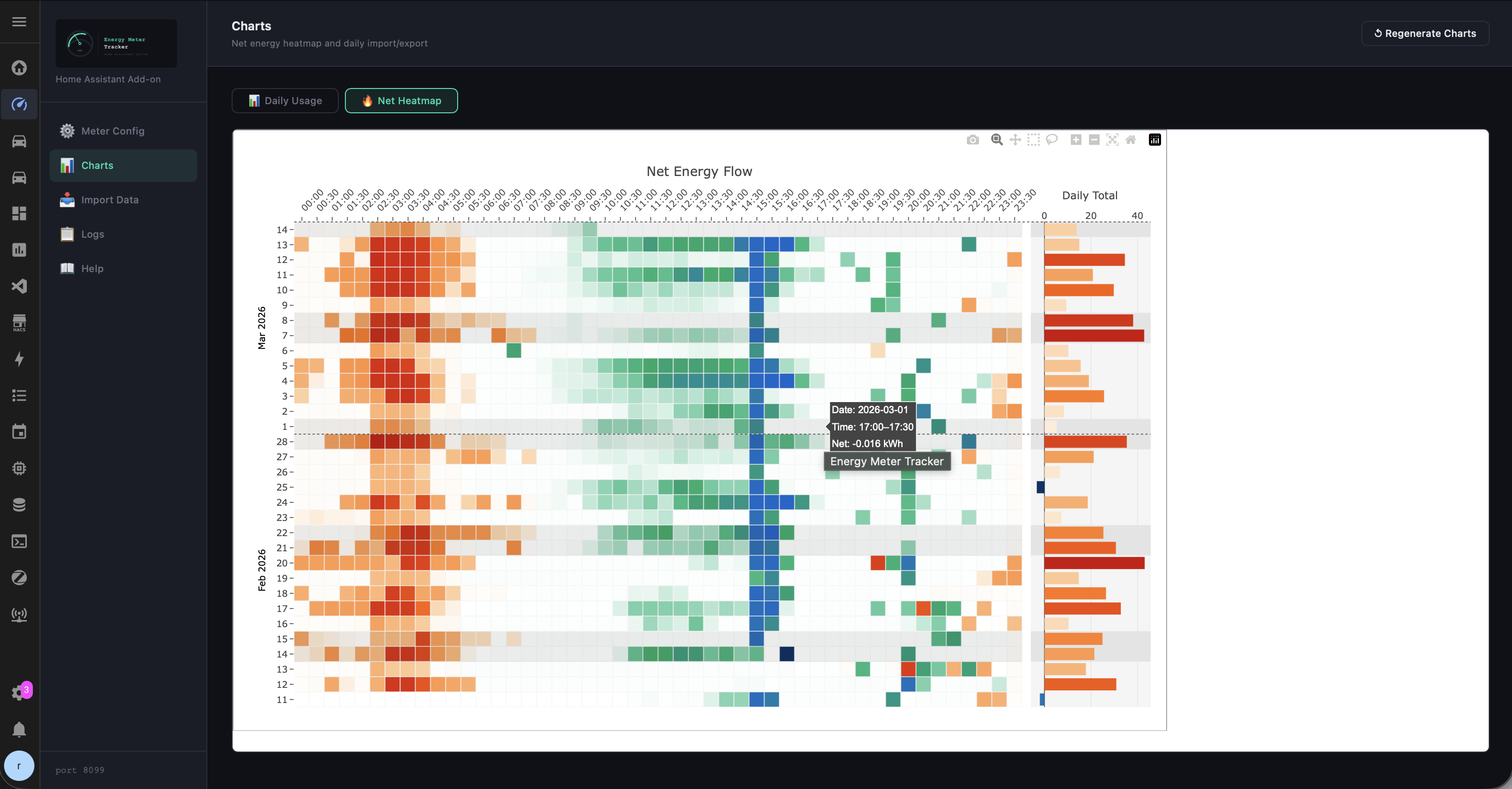

I’ve built a Home Assistant app that records your electricity usage in precise half-hour blocks — the same intervals UK energy supplier uses for billing.
Why?
The built-in Energy dashboard tracks totals but doesn’t give you visibility into individual half-hour periods. If you’re on an Agile or time-of-use tariff, or you want to understand how your battery, EV charger or heat pump is affecting your grid consumption, you need half-hourly data.
What it does
  • Records import and export meter readings at every :00 and :30 boundary
  • Boundary interpolation — even if your sensor updates every 60 seconds, the block delta is calculated precisely to the boundary timestamp, not to whenever the last reading happened to land
  • Sub-meter support — track EV chargers, home batteries and heat pumps; the engine distributes grid consumption across them using a grid-authoritative algorithm (the main meter is always the source of truth)
  • Gap filling — if the app restarts mid-session it detects missing blocks and interpolates them automatically
  • Backup — data is copied to /share after every block finalise, with zip snapshots before every config change
  • Four HA sensors — cumulative import/export kWh and cost, compatible with the Energy dashboard and Utility Meter
  • Web UI — config wizard, charts, logs viewer, help page, all accessible from the sidebar

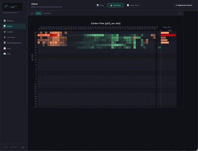

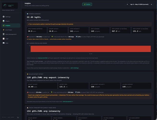

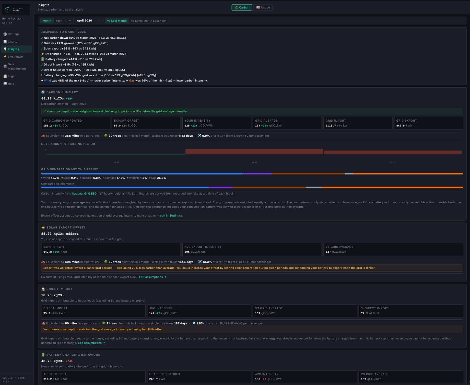

2.6.0 I’m hoping to release today. It partially completes the CO2 Insights vision that has been building since 2.3.0 onwards. Open to genuine feedback as I’ve developed this singularly and recognise the closeness to the project is often blinding. I do genuinely believe that this offers closer insight because we’re gathering block level carbon information against real metered usage.
2.3.0 → 2.5.0 gave us these building blocks enabling the insights

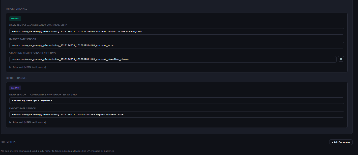

I just put my sensors from octopus addon from HA in setting and its work . Also work and for export
Interesting, what kind of resolution are those readings? the resolution is really important to the quality of the results. If the resolution is greater than 1 read per minute then results won’t match real meter reconciliation periods. There’s more info in the wiki and readme. Reads arriving late from cloud api’s will also have a negative effect.

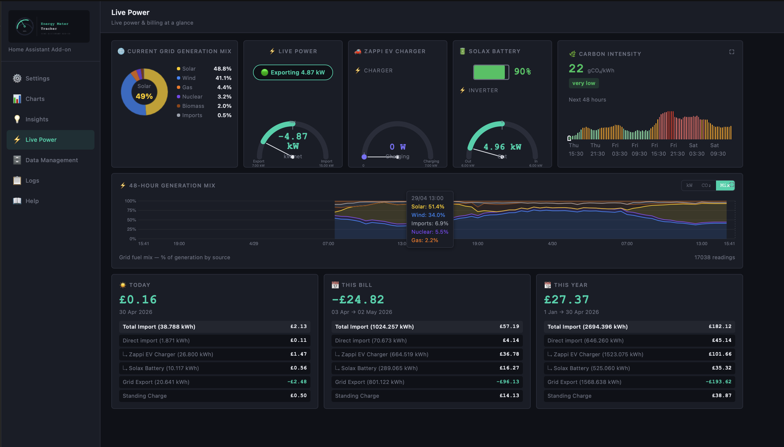

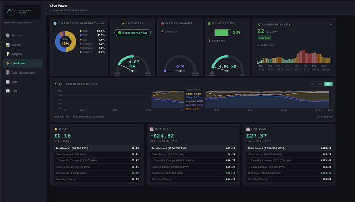

Release 2.8.0 resolves my cheap shortcut dealing with timezones, be sure to set the locale in settings until I update the meter config to self discover.
Also fuel mix is now included in the live power dashboard and carbon insights for UK users. A new usage insights tab is also available.
