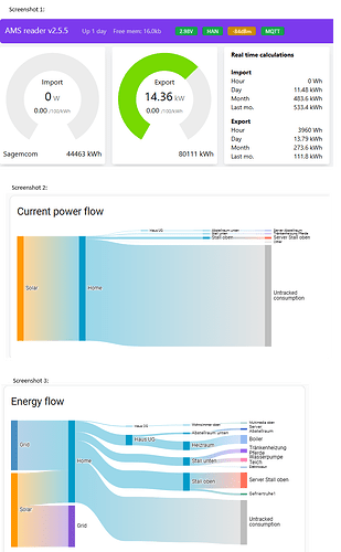

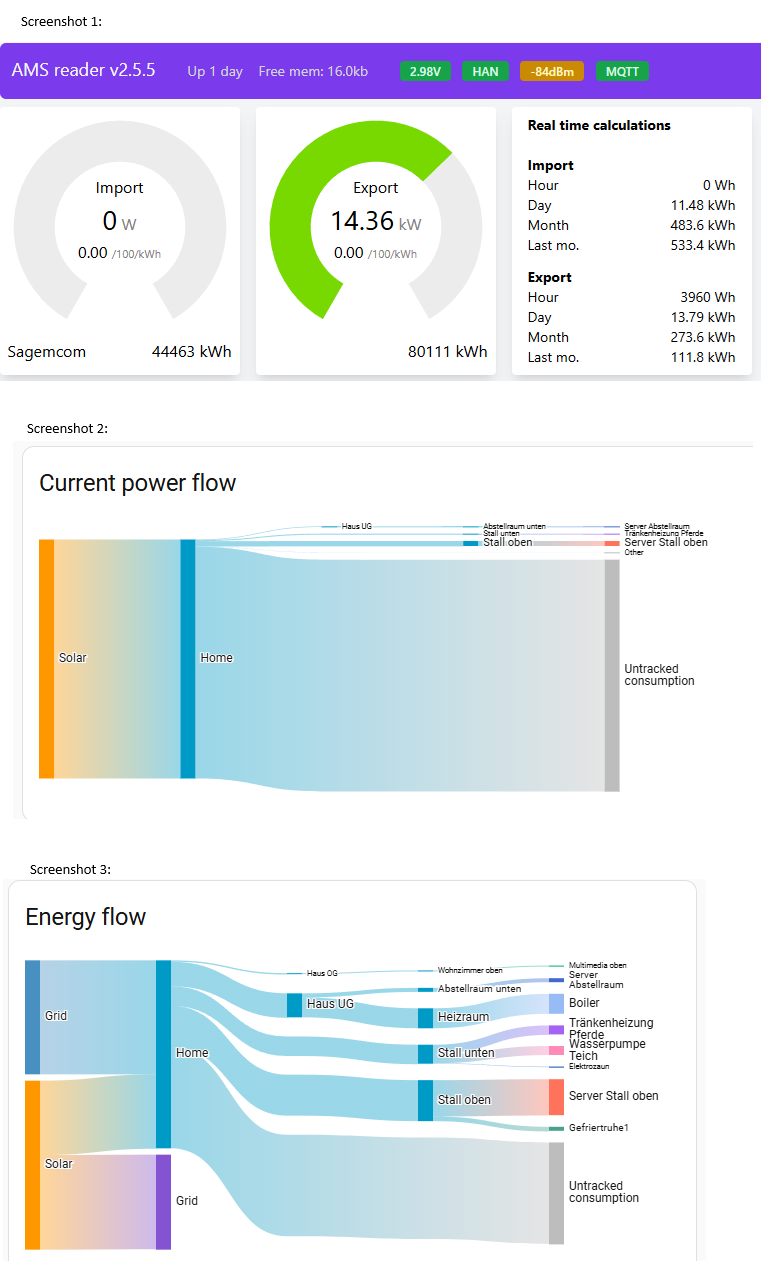

Screenshot 1:
I’m using AMS reader to get power flow data (import+export) from my power meter directly, currently exporting ~ 14kW.
Screenshot 2:
At the same time, in the “Energy → Now” dashboard I have this graph.
Here, energy flow shows all the solar power going into Home, and nothing going to Grid.
Screenshot 3:
But it should be more like this (Solar to Grid), as I’m exporting a lot of power:
Am I misunderstanding the “Now” dashboard? Shouldn’t there be a stream going from Solar to Grid as well?

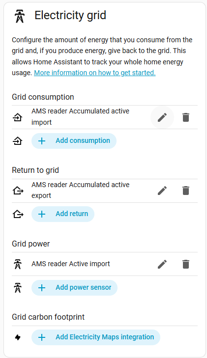

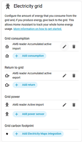

I missed giving you details about my Energy configuration:

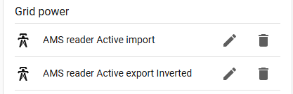

I figured, that I had to add the “AMS reader Active export” as “Inverted” to the “Grid power section”.
Issue solved. :white_check_mark:
