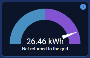

I wonder if I have something set up incorrectly. The “yesterday” I referred to was 29th of March, and now the display for that day seems to have disappeared. Instead I have a page headed 29-30 March which has one bar of the 29th and all the rest 30th.
So, using figures from this page the “big picture” is
and the net returned to the grid is
but still it shows self-sufficiency as
Am I being foolish for not understanding? Since it shows much more produced here than imported from the grid I would expect self sufficiency to be more than 100%.
This is the point of misunderstanding.
You did produce more than you used, but you used energy in a way (likely at night or above the power available from you panels) that required your house to pull energy from the grid.
Without the grid your house would not have worked the way it did, therefore the self sufficiency is below 100%.
That’s not a bad thing. It’s just how it is.
As I keep saying, export has nothing to do with self sufficiency.
Sell sufficiency is about how much of your production you use, it has nothing to do with how much you export, you are selling that to the grid.
And as pointed out above, you had to purchase some energy (most likely at night). So your self sufficiency is less than 100%.
There is no way you could be 100% self reliant without the grid. Not without a larger battery.
