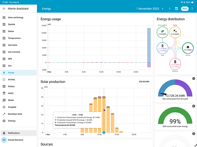

Energy tab showing nonsense
I don’t get it, this used to work, now the units are all over the place. Do they expect daily counters? Solar production is correct except for one device, the 38.7 kWh are OK, too, but that’s an all time counter, not a daily resetting one. Same for the energy usage. do I need to change this for resetting meters?

Looks like there was an issue with your grid energy sensor.
Go to the history panel and find the entity you specified for the grid energy. What does the history graph look like at the point where that massive increase (>14MWh) was at the end of the day?

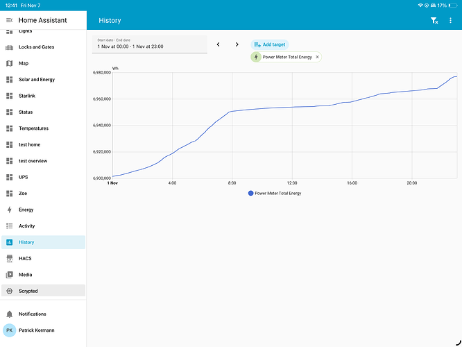

I couldn’t see 14 MWh anywhere in the history, it’s at ˜7 MWh (in Wh) and increasing.

Please share the history graph covering the same time period as the energy graph shown above.

Can you shoe what happens to the graph over the midnight boundary?
Zoom in to the range 22:00 to 02:00. I suspect it dipped in value a bit which would register as a reset for a total_increasing sensor.

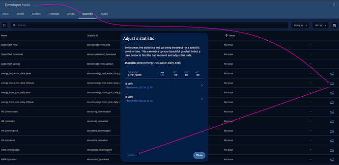

And you should be able to edit out the glitch in Developer Tools → Statistics. Find your entity and:
The Outliers button isn’t perfect but it should be able to find that huge jump.
Set the value to the average of the readings either side of that time by navigating to the value using the date and time picker in the card.

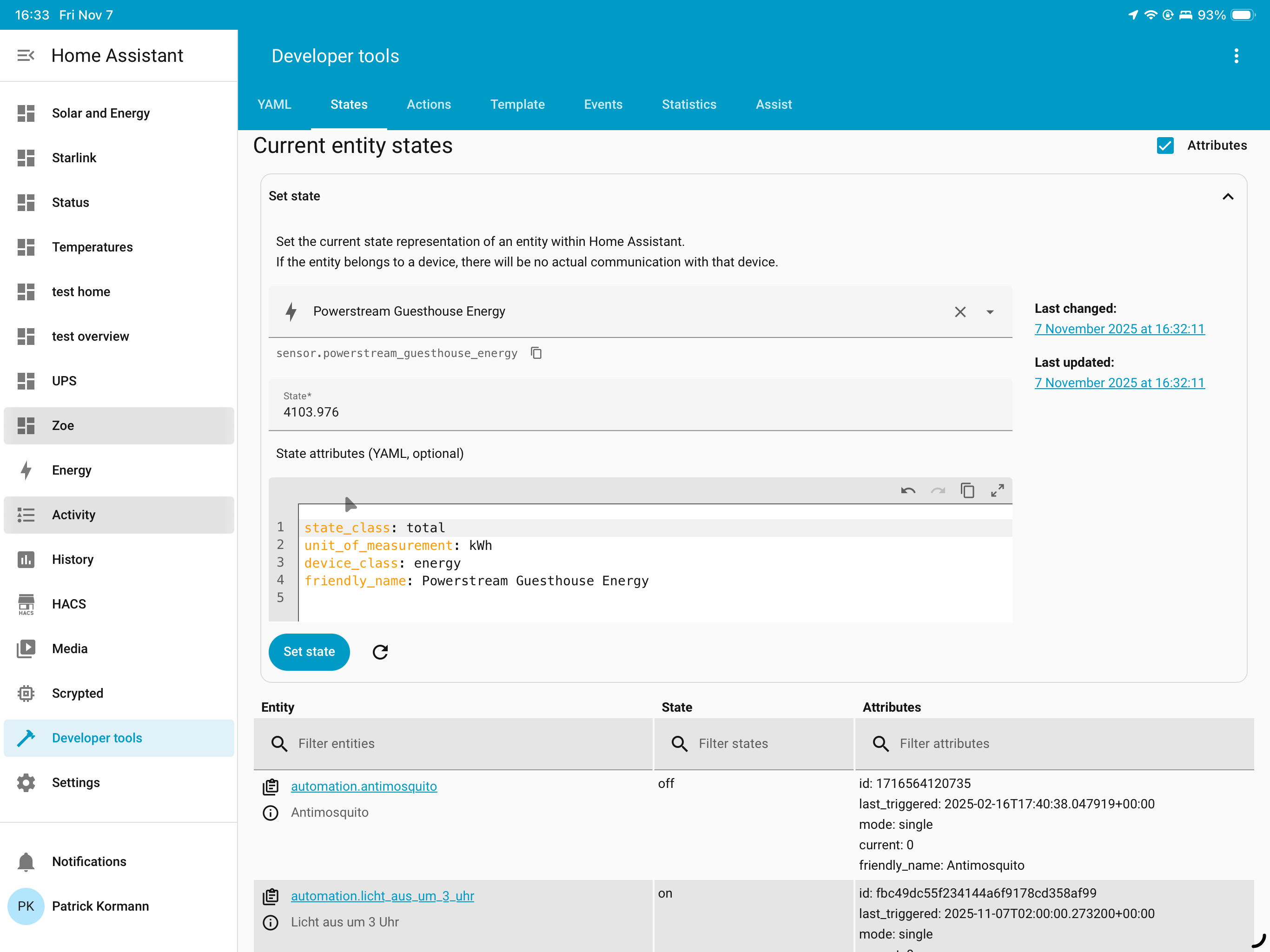

but what bothers me more is the other entry that’s wrong:
  - name: "Powerstream Guesthouse Energy"
    unique_id: "shelly_powerstream_guesthouse_energy"
    state_topic: "shellies/shellyplug-s-C8C9A3B8F93A/relay/0/energy"
    availability_topic: "shellies/shellyplug-s-C8C9A3B8F93A/online"
    payload_available: "true"
    payload_not_available: "false"
    device_class: energy
    state_class: total
    unit_of_measurement: "Wh"
this is how it is defined
But it shows up with kWh:
How can I correct that?
Click on the ⓘ icon beside the entity (or the entity itself in a dashboard), click the cog icon and set the unit you want.
