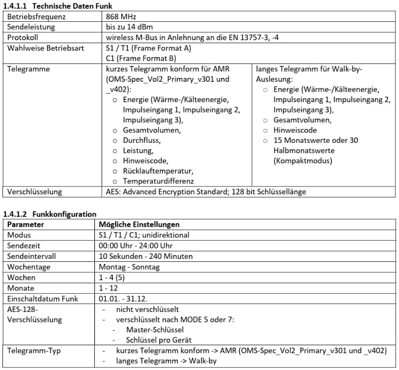

Sensostar U is also available with option to meassure heating&cooling. The telegram protocol also describes that heating & cooling data are part of the data stream. Is this also supported by your device?
I saw some discussions to order a new Sensostar and ask the reseller to do some parameter settings. Are these parameters relevant to your device too or are these only relevant for Engelmann wireless M-bus cards?

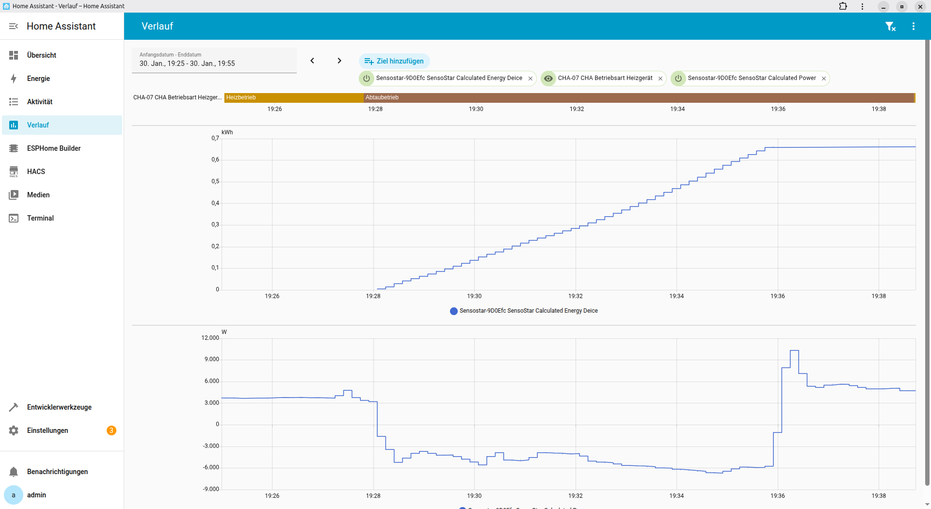

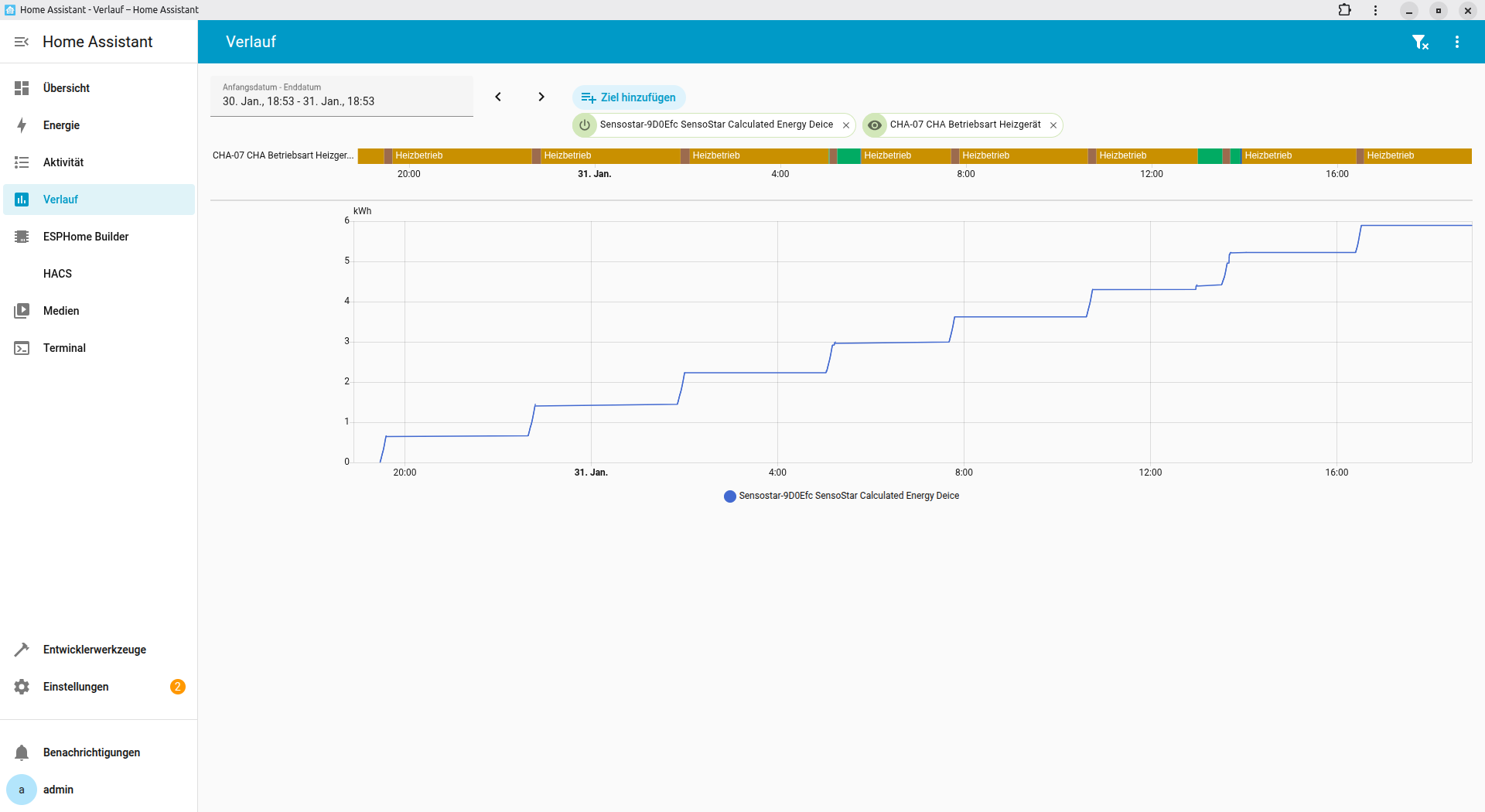

This ESPhome project already exposes a calculated power value, which can also turn negative, e.g. in case of deicing. Yesterday I added another parameter, which integrates the negative power values over time to calculate the deicing energy and exposes this to HA. It seems to work fine so far. I get ~0.7kWh thermal energy per deicing. You can find the fork: GitHub - olebowle/esphome-sensostar: Custom ESPHome component use with SensoStar module (see last commit).

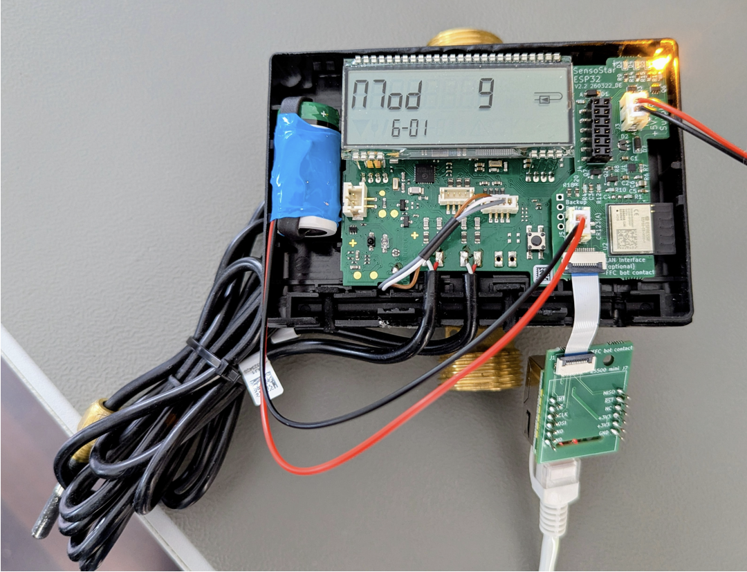

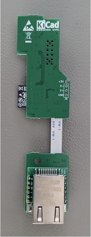

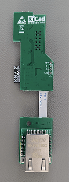

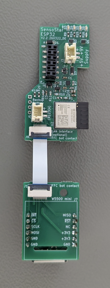

ESPHome Sensostar goes corded LAN
I have upgraded the current Sensostar hardware with an FFC connector that provides all the signals required to connect a wired LAN W5500 module.
From the next batch, you can choose whether you want to connect it wireless or wired to your home network.
Currently, what is missing is a fixture to provide a stable mechanical connection between the Sensostar heat meter and the LAN module.
I’m trying to design something that can be 3D printed.
Dirk
Awesome addition - thank you :slight_smile:
Two questions regarding this upgrade:
  1. would the be a hacky DIY way to attach a W5500 to the current version (which I ordered)?
  2. any plans for POE? That would bring is all together :wink:
