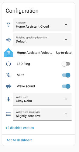

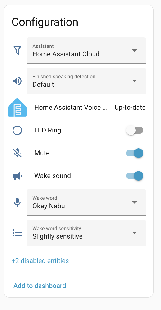

My current endeavor is to change the wake word for my Home Assistant Voice Preview Edition units, as I think “OK Nabu” is kind of weird and I find the three options all bad and limited. I tried out Porcupine before I found HA and it worked really well, but in the config panel for the device, it doesn’t seem to be an option at all to use another wake word provider:
Any idea how I can override this?
You have to compile and provide your own
Then you customize the VPE build:
Yep, currently I use the Alexa one also explained in the thread Nathan linked in a post further down the thread:
Not really happy to use the Amazon wake word, but it was easy to add and works best for me so far.
