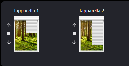

First of all, thanks for your great card.
Three things:
  1. I’m trying to use the card as “custom_fields” in a button-card, but inexplicably it cuts the roller shutter in half. Is there a way to solve this problem?
  2. Is there any way to activate the “tap-action” on the card? I would like to open a pop up that displays the card at a larger size.
  3. finally and it’s just an idea: but it would be nice to have a similar card also for the use of awnings. What do you think?
    Thanks in advance

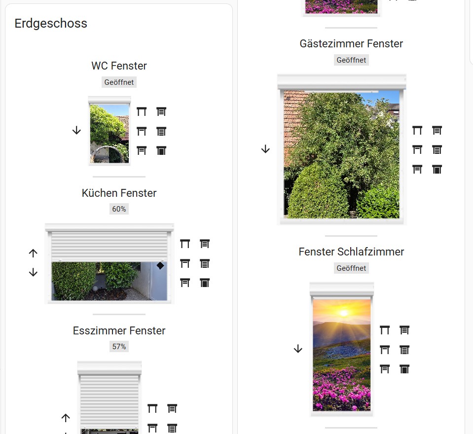

Thanks for the great card. This is what it looks like for me right now. I installed and customized it for the first time today.
Excerpt from the Yaml code:
type: custom:enhanced-shutter-card
title: Erdgeschoss
entities:
  - entity: cover.rl_wc
    view_image: wc_01.png
    image_map: /local/community/enhanced-shutter-card/images
    base_height_px: 130
    base_width_px: 80
    top_offset_pct: 13
    shutter_slat_image: esc-shutter-slat.png
    window_image: esc-window.png
    shutter_bottom_image: esc-shutter-bottom.png
    buttons_position: left
    button_up_hide_states:
      - open
      - opening
      - closing
    button_down_hide_states:
      - closed
      - opening
      - closing
    button_stop_hide_states:
      - open
      - closed
      - partial_open
    show_tilt: true
    disable_partial_open_buttons: false
  - entity: cover.rollo_kuche
    view_image: kueche_01.png
    base_height_px: 150
    base_width_px: 240
    top_offset_pct: 13
      - open
      - opening
      - closing
      - closed
      - opening
      - closing
      - open
      - closed
      - partial_open
    show_tilt: true
