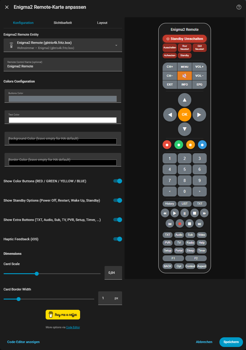

i just released v1.6.0 with following features:
  • Multilingual support: Card translated into German, English, French and Turkish
  • Visual card editor with native HA entity picker — no YAML required
  • Color palette picker in the editor for all color fields (buttons, text, background, border)
  • iOS haptic feedback on button press — toggleable in the editor
  • HTTPS / SSL support including self-signed certificates
  • HTTP authentication with username and password
  • Hostname support instead of IP address only
  • Port auto-switches to 443 when HTTPS is enabled
  • Transparent outer remote wrapper (only the border remains visible)
Please test, and if something does not work open an issue :slight_smile:
