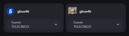

action: enigma2_mqtt.message work fine both “popup and toast”
but not the picon, only the screenshot.
a sample: On the left is “enigma2-receivers-integration” and on the right is yours “enigma2_mqtt”
