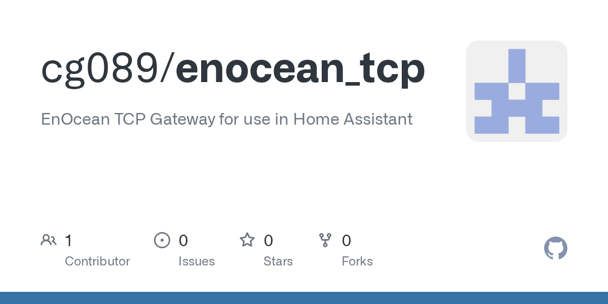

I am working on a small custom component, so long it is working for me. Feel free to fork!
