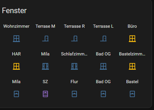

But how can I show now the states of each window in the dashboard? Something lilke this (must not be graphical, cold also be open/tilt/closed…
BR
sp00ky
According to the code, you should already have an entity state_2p in the HA device which correctly display as a window.
Found it, merci! Do you also know how to make this kind of graphical overview?
I guess this is a glance card (Glance card - Home Assistant)
