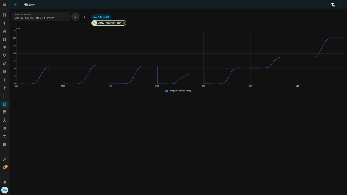

For a year now it has like clockwork reset at midnight and displays only energy produced that day, for the last few days it has not reset and just keeps building on the production of past days. I did not see any settings that would cause this. Looking for a little guidance. As far as I can tell there have been no updates during this time. HA is running on a Raspberry Pi5 8gb, Enphase system is a 6.4kw system with 10kw of 5IQ batteries, I believe they refer to it as a 3rd gen system. Thanks in advance.
It’s the Envoy that is reporting wrong numbers for some reason. There’s more reports of this starting to happen (again). (See HA issue 161892 and description in the docs)
