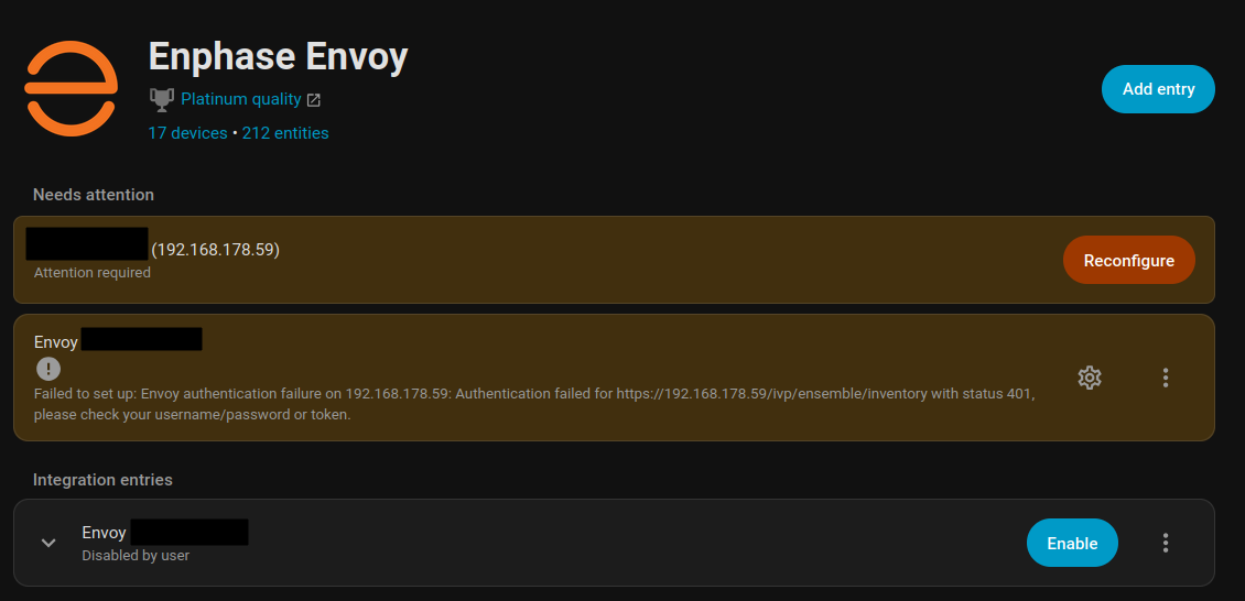

Immediately after though, I get the problem you see in the attached screenshot.

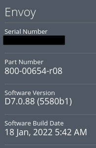

I’m a bit confused about the Envoy firmware, your screenshot shows D7.0.88, which is an old firmware. Current versions are D8.3.x (mine is at 8.3.5167), yet you write Enphase says it’s current.

As for the authorization issue, nothing wrong with your Enphase account or the token. In the log it can be seen that the token is retrieved and still valid.
When it tries to read data from the Envoy it receives the not-authorized status. This problem is typical for the D7.0.88 firmware. (See Github issue 148028). Which brings the question which firmware your old envoy was running?
The debug log shows you have no current transformers (CT) installed, Is your a Envoy-S non-metered EU one? I have such a one for 3 years now and it is on D8.3.5167 as of last summer.

Now, the annoying thing is that it seems that Enphase support is lying (or lazy), and it does seem that there should be newer firmware. I am not the person with full access to this gateway (admin) because my installer guy is. So I’m not sure how to update the firmware to whatever is the latest right now…
Firmware release notes are here. Even if you have older micro-inverter types it seems 7.6 or 8.2 should be possible.
