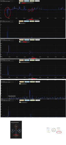

Just to clarify: does the Cloud API that provides data to the Enphase app apply smoothing to the values?
As you can see in the screenshot, sometimes the current net power consumption shows negative values—which could be interpreted as power export—but that’s not actually possible in those moments.
This discrepancy seems to cause differences later in the Cloud API data.
Please see my screenshot for reference.
No idea what data manipulation the cloud api does nor what data the Envoy is reporting to the cloud.
That value come directly from the Envoy. So it’s something the Envoy is picking up or wrongly reporting.
The export spikes seems to coincide with the spikes in the encharge energy puissance and battery charge/discharge power. You may want to check times on that to confirm
I dont understand why the value on the API cloud are correct but not for local API …
The measurements for the local API and the cloud API are performed using the same CT …
In my opinion, it has software processing/smoothing code so that users do not see export errors at night…
EDIT: here we can see also 'That “Balanced net power consumption” and Envoy xxxx “Current net power consumption” Give exactly the same mistake
See at time 10:30
EDIT2:
Here we can see that, for example, on 24 October, Enphase was having a lot of trouble with the measurements… Yesterday the values were wrong, and this morning I see that they have been corrected as if by magic…

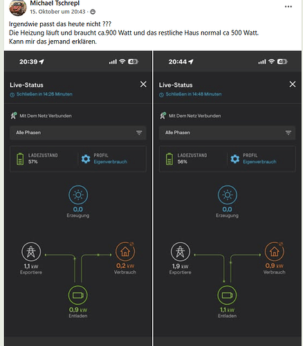

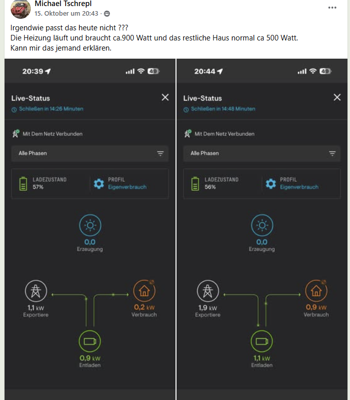

You never see this kind of negativ value ?
For Enphase Value
it s seams that some another people have the same Problem…
Take a look here, Current Power Consumption is not matching real world · Issue #153265 · home-assistant/core · GitHub. That reports something similar in relation to batteries. Might be the same.
