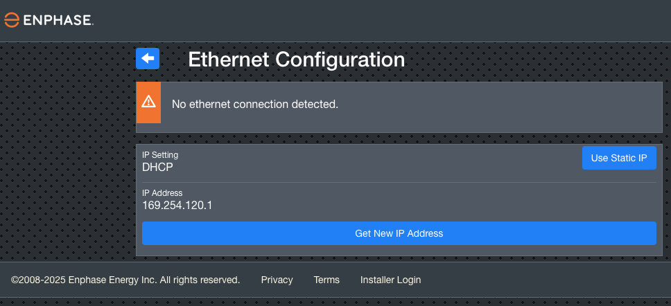

When I open the Enphase default web page and login using the token (probably from your MAC for now), and then open the ethernet settings (mine is on wired connection) I see DHCP mode

I have found (!! :grinning: !!) the bug for 1 site, mine in the Netherlands.
When I incidentally checked my Ethernet settings I found:
I have tried to fill in the gateway as it was missing before, but I didn’t succeed. Then I wanted to get rid off these settings and I clicked on DHCP.
The result was:
Then I tried to get access to https://192.168.1.192 and voila! Somehow, it has mixed the gateway from ethernet (0.0.0.0) with my WiFi settings and therefore it didn’t work. I think this is a flaw, as if the ethernet is not connected at all, as reported by Envoy as well, it shouldn’t mix ethernet settings with the WiFi which has been resolved automatically.
