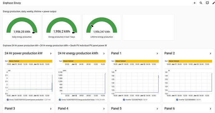

I've setup HA for my solar, battery & ashp installations & all was working OK until today.
Photo shows 3 gauges, Daily energy production, Energy production in last 7 days & Lifetime energy production. Today those separate readings changed from their correct values to all 3 gauges showing the same reading of 1,956xx kWh, which is the current Lifetime energy production! I checked each entity for the 3 gauges, all 3 gauge card entities were correct but the each gauge displays the same value. I tried restorng from HA backup but the problem remained.
I rebooted HA, no change! All 14 enphase microinverters are displaying correct readings as is the enphase app. I tried deleting & reinstalling the entities, no change.
Any advice would be appreciated

In fact, there was an update of the Envoy gateway's firmware the last few weeks and the result was an misreporting for some entities. There is an issue : Enphase - Envoy - issues with today reporting of "todays Energy" · Issue #172111 · home-assistant/core · GitHub
What I did is create an utility meter entity based on the production of today with a reset every night at 0pm.
