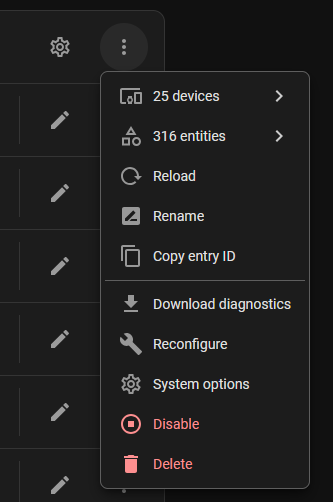

If that is not the case, can you share a diagnostics report with test fixtures included?

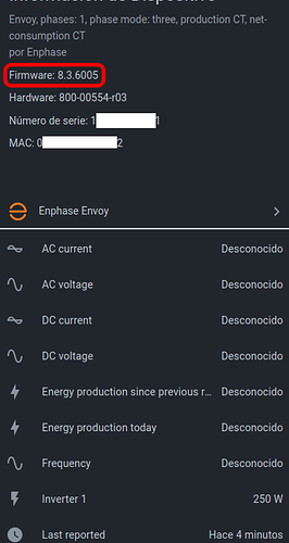

I have exactly the same problem, but it started immediately after my IQ Gateway automatically updated from firmware 8.3.5528 to 8.3.6005.
Before the update, all inverter entities were working correctly.
Now, only Current Power, Last Reported, and Lifetime Maximum Power are available. Most other inverter entities (AC/DC voltage, AC/DC current, frequency, energy today, etc.) are now Unknown, as shown in the attached screenshot.

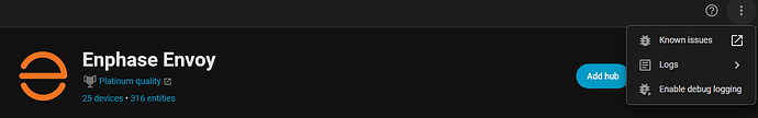

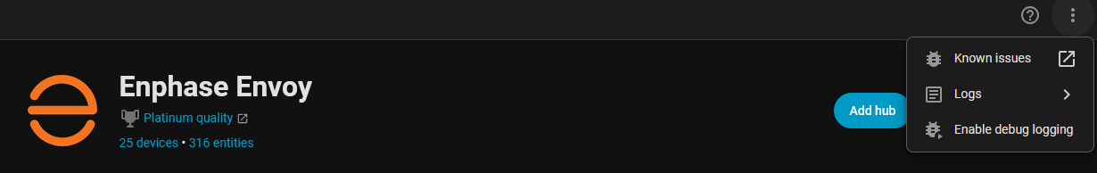

Enable debug on the HA Enphase envoy integration
then reload the integration
Let it run for couple of minutes and then disable debug again. The log file with the information will download. Check if for any information that contains Disabling inverters device data endpoint.
