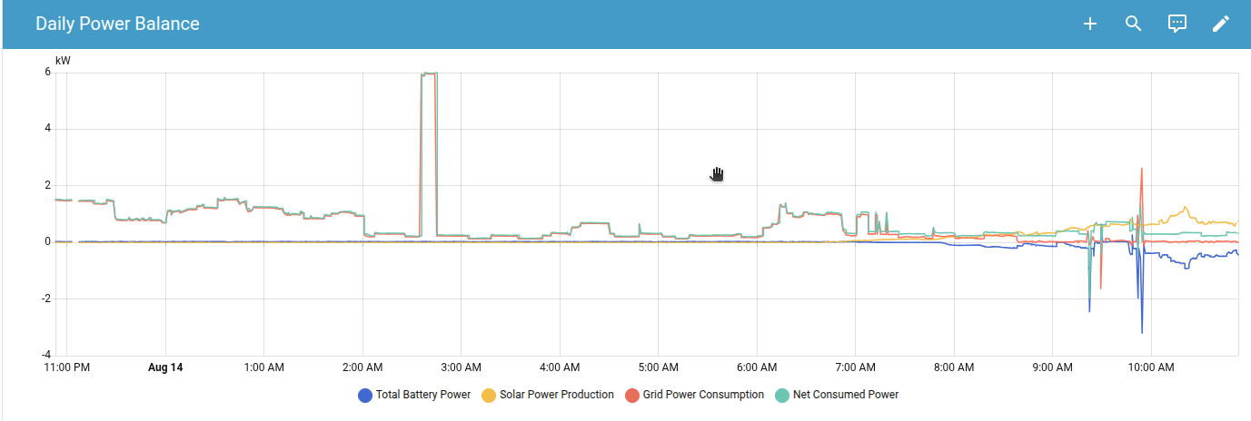

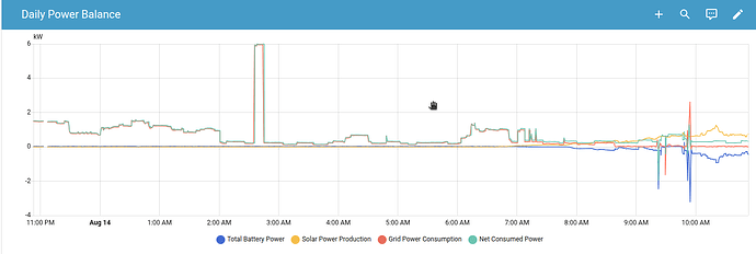

I plot these values as single panel History- graph
title: Daily Power Balance
type: panel
cards:
  - type: history-graph
    entities:
      - entity: sensor.total_battery_power
      - entity: sensor.envoy_202406020944_current_power_production
      - entity: sensor.envoy_202406020944_current_net_power_consumption
      - entity: sensor.net_consumed_power
    hours_to_show: 12

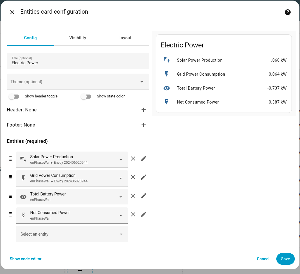

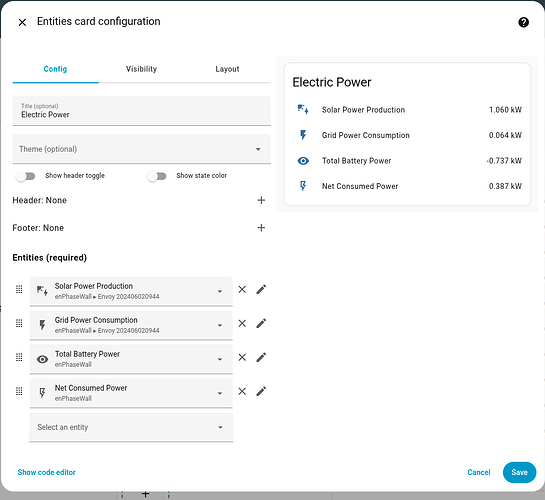

For those who prefer a text display over the plot:
