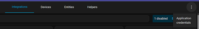

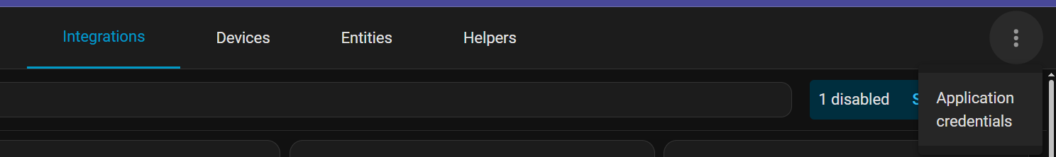

Settings > Integrations > 3 dots > Application Credentials
Click it, find the Smartthings credentials & delete the entry from the 3 dots on the right. Restart HA (just in case), then add the integration again.
Great! It’s now working correctly, with the proper account. Thanks
