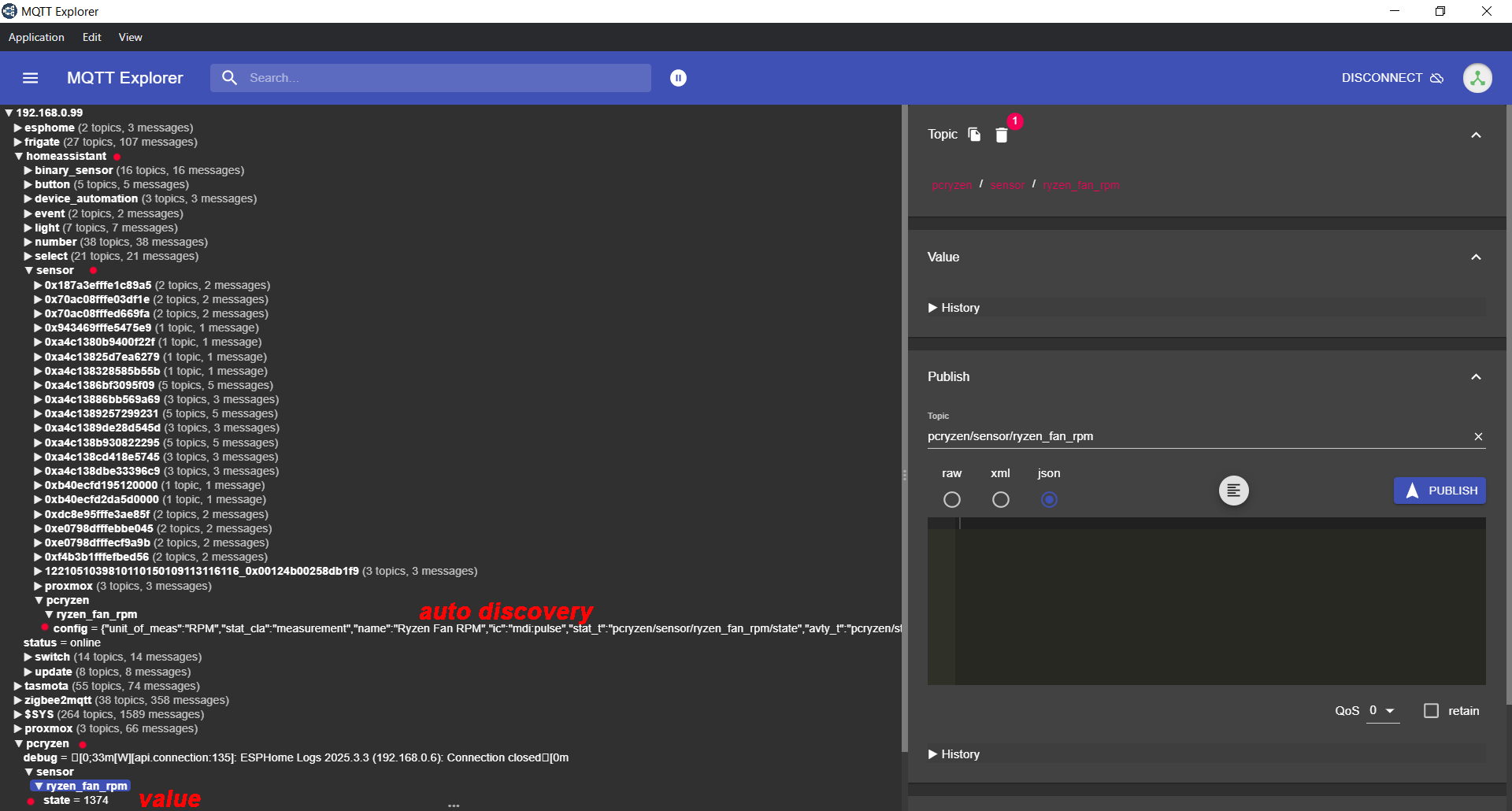

Thanks for that ! I added MQTT to tell my greenhouse ESP32 not to return to deep_sleep when i want to make a change or there is an OTA firmware update (which works well), but all my other entities got duplicated - which I wasn’t expecting.
Thanks all!
I am however still not able to get rid of the duplicate entities and I am not sure what to do now.

Then, I have removed all the (retained) topics for this device in MQTT explorer. Basically, I have removed all traces to this device to be sure.
Then, I have removed the device from ESPhome and rebooted Home Assistant.
The device is discovered in ESPhome devices overview, but again with the duplicated entities as mentioned in the startpost.
The auto discovery topics are in “homeassistant” (default).
So you have a topic for auto discovery and another with the sensor values.
You need to remove them too.
When I’m doing a test, I usually select the IP in the MQTT explorer and delete everything, letting MQTT rebuild itself again.
Be careful with this procedure, because a device that sends few updates will disappear from HA until the next update.
Ok, will test that!
This fixed it !
