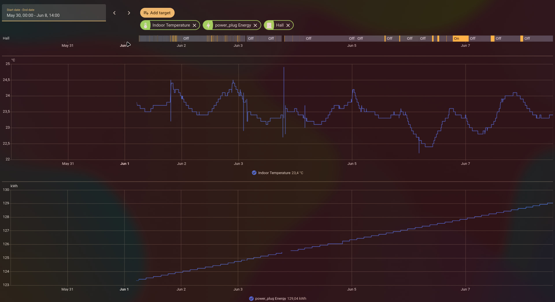

Hi, for some reason all my entities keep history for only 7 days. It applies to sensors with or without state class defined. As far as I know, when I dont define anything for the sensor (or entity) it should keep statistics for 10 days. I dont have recorder database configured. I started happening few udpates back, dont remember exaclty when, this year, but I couldnt find any mention of any changes regarding this.
statistics are kept forever, history is kept for 10 days. The lack of a state class means you will not get statistics for that entity, but you'll still get history. How are you determining that you only have 7 days of history?
From the history tab.

Wait another day to see if you get more history. There's no reason your system should purge/delete after 7 days if you didn't configure recorder to do so.
I have been monitoring it for a while now, but sure, I can post same history tomorrow.

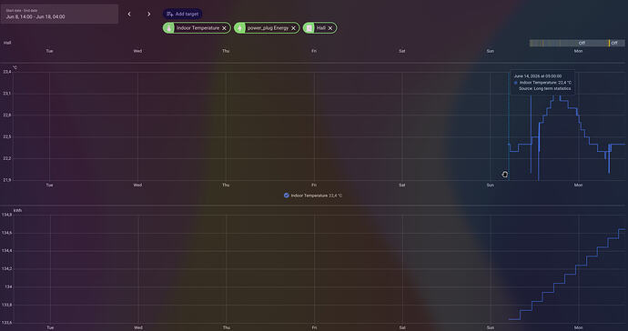

History got deleted again, but logs from yesterday got overwritten...
Are you sure it’s not your DB-file which periodically gets corrupted ?
Not sure about the “logs got overwritten” issue, Have you tried to actually “Scroll” eternally in the RAW-Log View ?
History got deleted + Logs ( cleared somehow ), does indicate …. something’s seriously “unstable” in your system
My docker log is limited to 50MB, one file. The home assistnat logs in /config starts today at 8, when I restarted the container unaware of the history detetion.
I guess the DB file could get corrupted but dont know hot to verify this or test this.
