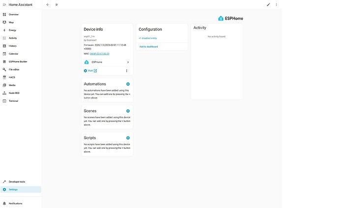

and heres how it looks in the settings…

Have a look what you have under disabled entities
That just shows firmware… Only one entity.
