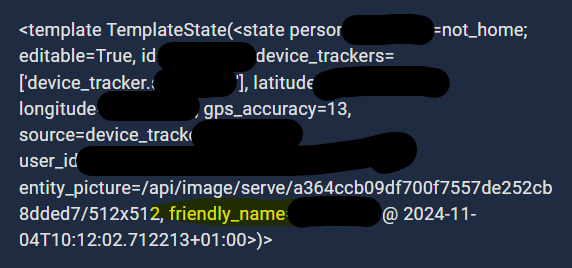

And is there a reason that I should know why it is “name” instead of “friendly_name”? I feel like the object has a friendly_name attribute, not name.

had to change is not None to != None because I kept getting the error No Test named None found
My understanding was that with None you should use is not and only with actual comparisons should you use operators.
Do you know why that is the case?
no, don’t do that, it should be
{% set person = states.person | selectattr('state', 'eq', 'home') | selectattr('name', 'eq', user) | list | first | default(None) %}
{% if person is not none %}
  Welcome Home {{ person.name }}
{% else %}
  You're out and about, have fun.
{% endif %}
typo on my part
oh, wasn’t aware that this is case sensitive! Thanks for the explanation!
