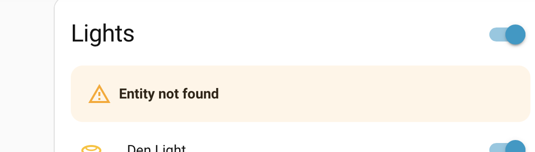

"Entity not found" in default Overview dashboard
I have a couple items on the default Overview dashboard that are showing as “Entity not found”. Typically, these are removed automatically as this Overview dashboard is not user managed. Is there a way to remove these?
I have never seen the default dashboard, but it should work like other dashboards. Click on the pencil icon (top right), edit the card and delete the missing entity.

No it doesn’t. You first need to 'take control ’ before you can edit the autogenerated dashboard.
The default dashboard doesn’t work like other dashboards. You can’t edit or delete entities since it’s all automatically managed.
I do have my own dashboards but this is just an issue I’ve ignored for a while but wanted to see if maybe there’s a solution out there for it.
Thanks for the suggestion. When I use that command, I’m not seeing anything pointing to which entity it might be. This has been an issue for 6+ months so I’ve reloaded and restarted home assistant many times but they persist.
Can you post the views object that it returns?
Or you can just look through it for the card titled Lights and see what entities are in the card.
There’s nothing in views object that points to the Lights card. This is using the Safari web inspector console:

Ah my bad you’re right, I was looking at my wrong dashboard. How about this instead:
document.querySelector("body > home-assistant").shadowRoot.querySelector("home-assistant-main").shadowRoot.querySelector("ha-drawer > partial-panel-resolver > ha-panel-lovelace").shadowRoot.querySelector("hui-root").shadowRoot.querySelector("#view > hui-view")._layoutElementConfig
I was able to find the entity using that command:
  • light.desk_ambient_lights
I have two entities that are from my Hue integration called:
  • light.desk_lightstrip.
I think at some point I had these two grouped into a single entity called light.desk_ambient_lights (with an s), but seems to have since been removed or deleted, but it’s still trying to show up on the default Dashboard. The odd part is neither of the two entities mentioned above from the Hue integration show up under the Lights card, but do show up under the specific room card (all of my other lights show up both in the Lights card and their respective rooms).
If I create a new Overview dashboard, the same issue happens. Searching for those entities, they don’t exist so it’s almost like there’s a reference to them somewhere that Home Assistant is still pulling from but they don’t actually exist.
Sounds like it’s still in your entity registry maybe, you’re sure it’s not visible in the config/entities panel?
Is anything found by either of these commands?
document.getElementsByTagName("home-assistant")[0].hass.entities['light.desk_ambient_lights']
document.getElementsByTagName("home-assistant")[0].hass.states['light.desk_ambient_lights']
Ah I think I figured it out. A long time ago I created two groups, group.lights and group.doors_and_windows (can’t remember exactly why). Both of those groups had the entities that were causing the issue, and it seems the default Dashboard will show those groups. The weird part is when I searched for those groups and opened it up (pop up view), those entities that no longer existed didn’t show up but on the default Dashboard they do with the “Entity not found”.
Appreciate the help! Figuring out which entities were the issue allowed me to quickly figure out what the issue was.
