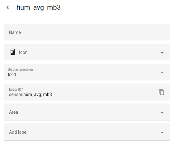

Upgraded HASS from 2024.12 to 2025.8, some sensor values display went crazy despite precision set to a single digit.
For example 2 calculated helpers, sensor.temp_avg_mb2 is fine sensor.hum_avg_mb3 is not.

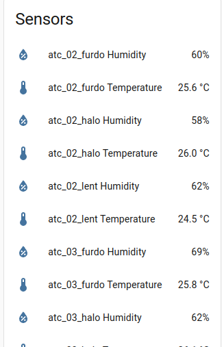

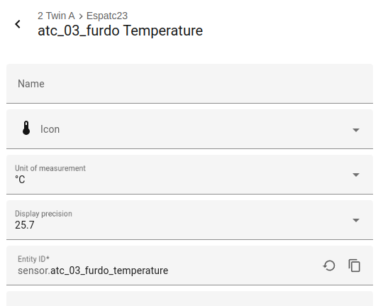

I have also sensors acting as such
Tried settings precision to default/custom 99.9 to no avail…
Also weird that sensor readings seem to be all 99.9 precision
what’s wrong?

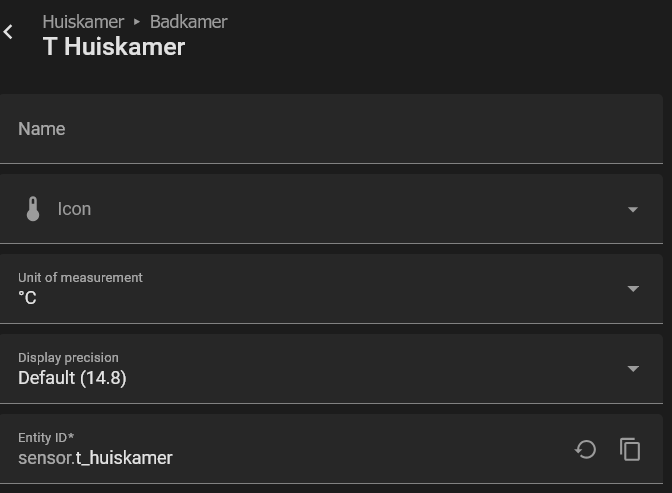

Still stuck with this problem, I know I can use round=true or with a number, and yes I know I can set a default precision, but in some cases all this will not work, example with a mini-graph card:

Then you need to report that to the developer of the third party card.
Thank you Tom, had not thought about this, cause it was in so many different cards and and representations of values, many of which I could repair with a simple round statement in the retrieval of the entity.state or value expression.
But you see no other option to adapt the code line:
 </ha-icon><span>${entity.state}°C</span>`
in another way? Cause as said there are more cards affected like this one!
Screenshot 2026-01-12 at 12-31-32 Probeer – Home Assistant
And it looks terrible, I disabled several pages from my front end to not see all of these.
