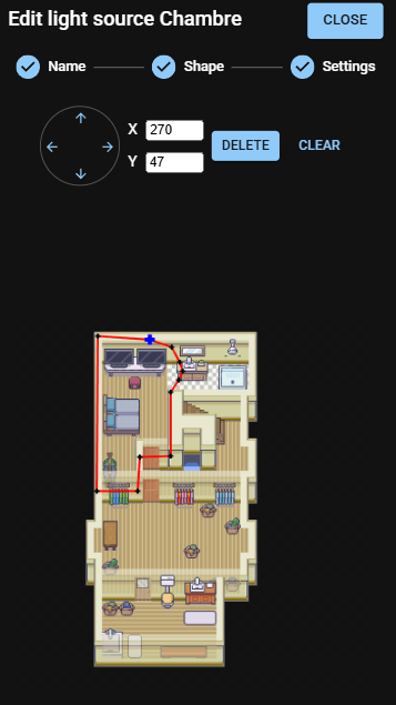

So I came up with a tool to help in this process currently hosted here: https://holynoodle.github.io/
It allows you, once you have created your floor image, to manage your layers and light sources.
Configure your day/night (or others) layers
Create and edit light sources (for layers (windows for example) and rooms (bulbs for example)) and set the light color
And play with it
You can then download a zip of all the images required and a template YAML for starting your Picutre entity card. The images must be put in the www/ folder of your HA so they are available. The path in the YAML should be updated in case you don’t put the image in the same place.
This whole app should work on mobile and on computer. Without any special requirements but it may be slow as I didn’t optimize the code. You should have precise control over the shape of the light sources. There is still work to do on the gradient transparency parameters and result but this is good enought I think.
