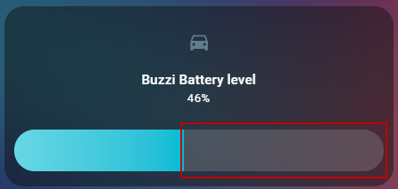

Entity Progress Card - Color of Background bar?
since I have been looking already in the documentation and elsewhere, does anyone know how to change color of the bar in the background?
There does not seem to be a config option, and I could not figure out how to do it with card-mod. Is there a way to change that color?

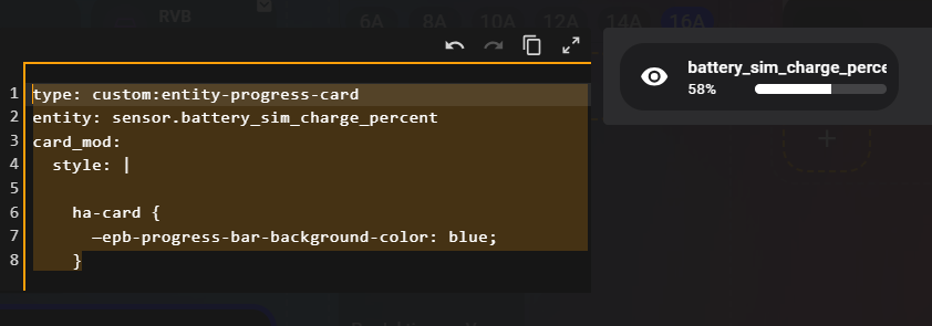

Unfortunately it seems like I m doing it wrong or it does not work…

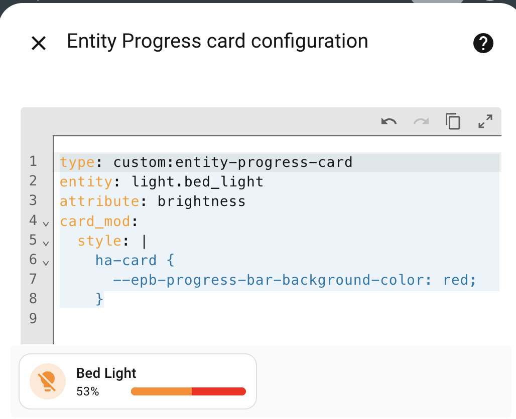

Should work. I think the forum has made my -- into a long dash or something, or because my response was on iPad before. My yaml below works fine.
type: custom:entity-progress-card
entity: light.bed_light
attribute: brightness
card_mod:
  style: |
    ha-card {
      --epb-progress-bar-background-color: red;

Thanks, you are right. I also did not see it and simply copy your code.

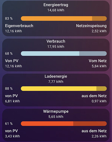

Also here is the result.
