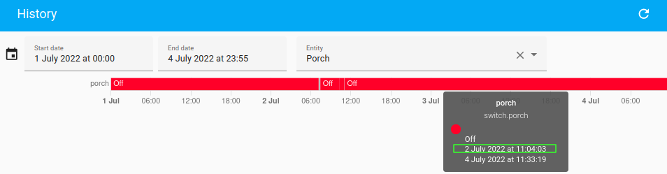

I’m not seeing this behavior for a switch (running Tasmota 12).
Telemetry has been configured to report every 30 minutes.
Screenshot from 2022-07-04 11-40-44
According to the switch’s History, the last time it changed state was July 2 11:04.
According to its information displayed in Developer Tools > States, its last_changed is July 2 11:04.
Screenshot from 2022-07-04 11-31-52
The following template reports the same result (July 2 11:04).
If it was force-updated every time it received telemetry, then the value of last_changed should be a time today (July 4), but it isn’t.
