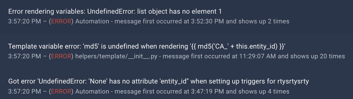

Could you share a trace log of the automation run when this error appears?

The error with the notifications was related because 2 of my devices were initially registered with the same names even if they have been manually modified after. But this is only at the first registration that is relevant. I had to deleted my devices and register it again.
For the others errors, I was not used the right state. I thinked I should use the state provided by zigbee2mqtt, but I saw in the forum that I need to use the “on” state.
