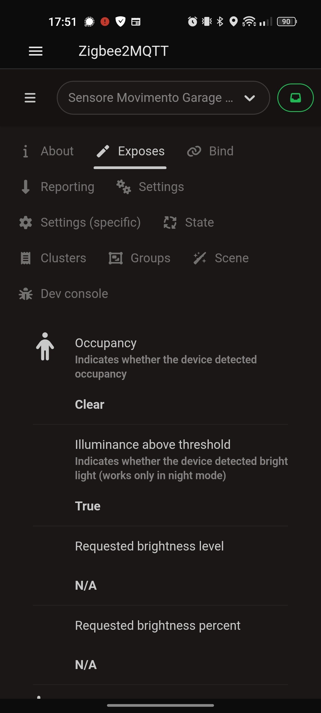

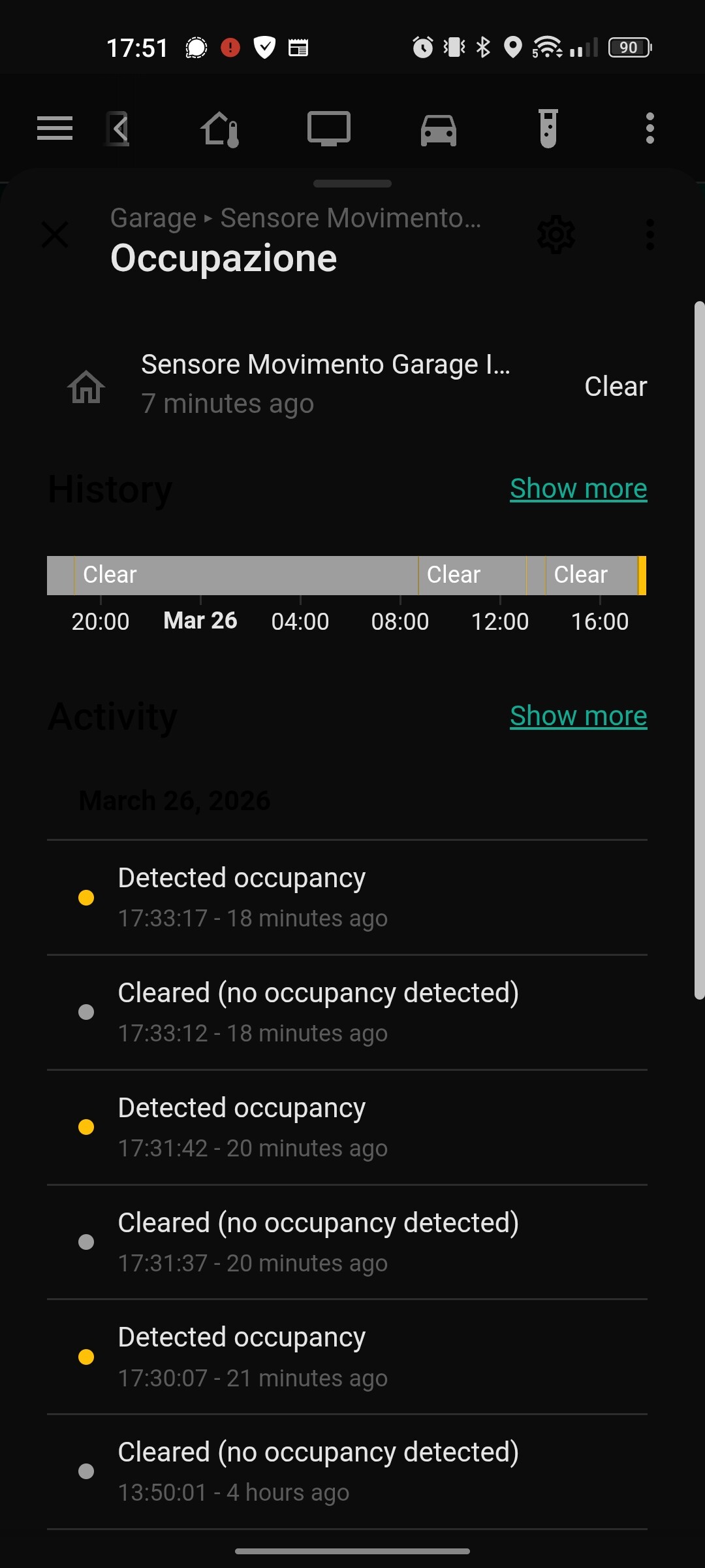

I have a presence sensor from IKEA (Tradfri) that usually works fine but sometimes it gets stuck to “occupied”.
The odd thing is that if I check its status in Zigbee2mqtt its occupancy entity is correctly showing “clear”, while in HA it shows as “detected”. This reflects on my automations because lights will never turn off. The only way I’ve found to make everything work again is to reboot my machine.
