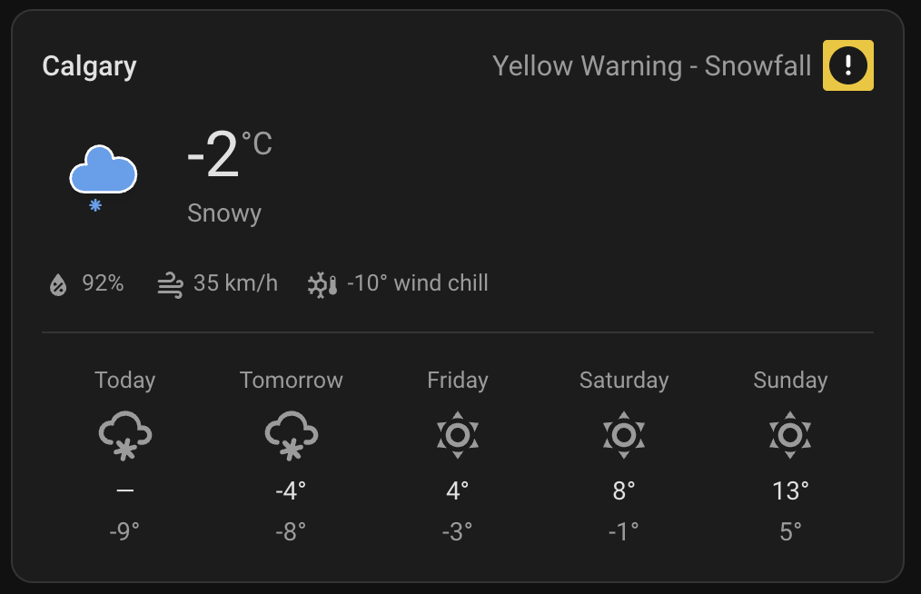

I’m using the code below in my Dashboard to display weather alerts from the Environment Canada integration. Card-mod and auto-entities must be installed.
It will pulse a solid frame of red, orange or yellow: around the row, with red pulses being the fastest. The background will be a translucent color of the highest alert color. It will sort by red, orange or yellow alerts followed by warnings, advisory and watches. Statements will be grey and will not pulse. Note that this will only list two alerts per alert type.
The appropriate icon will be used and that icon will match the color of the alert. Alerts are clickable - you will need replace “report_e.html?onrm26” with the correct link for your area
Enjoy.

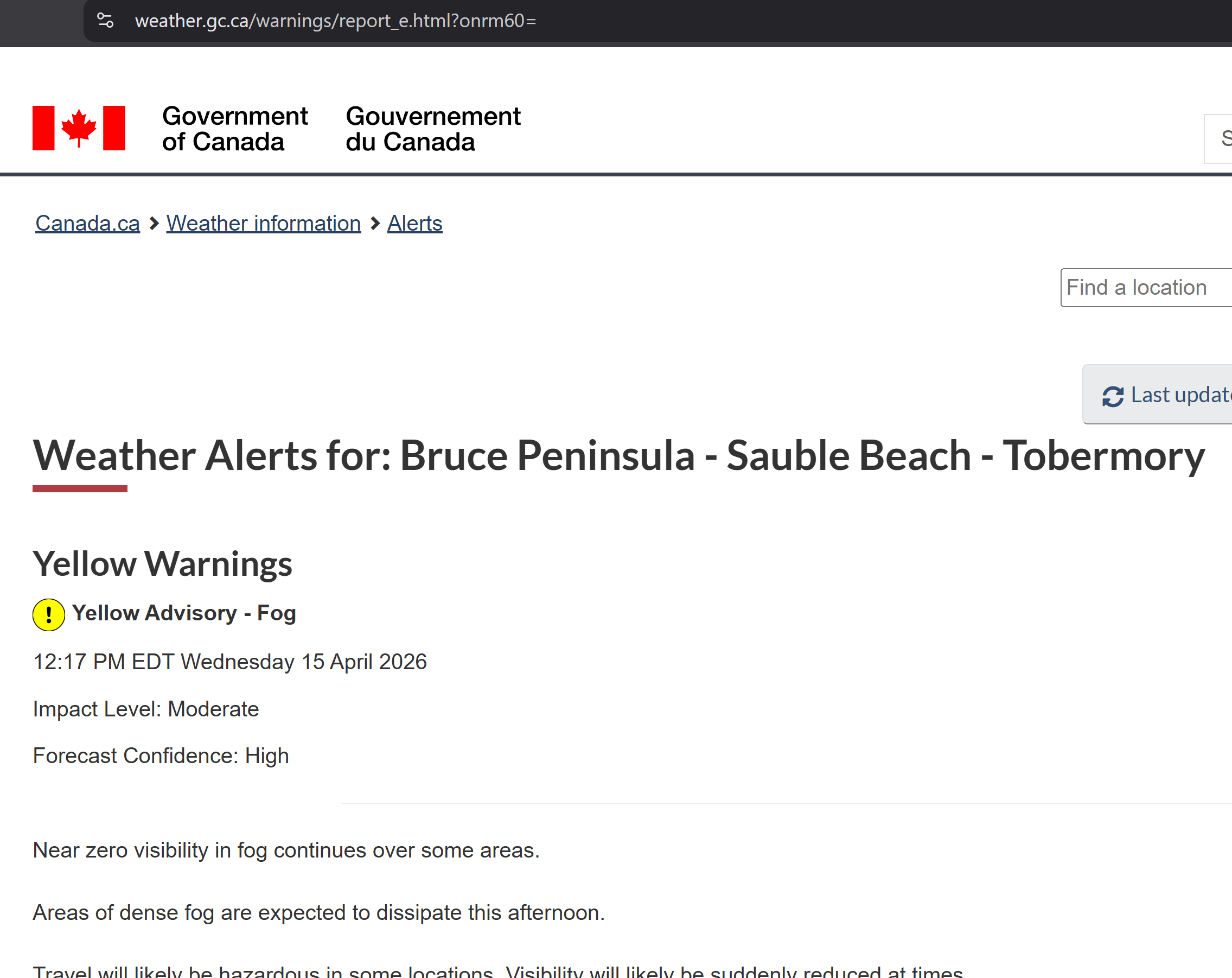

Update: It appears that Environment Canada has changed the wording of the alert_1 attribute in that the color indicator in the text is not being included. For example, the alert_1 attribute would be “Yellow Warning - Severe Thunderstorm Watch” but over the past few days the alert_1 attribute is “Severe Thunderstorm”.
This may be a glitch or it be a change in how this information is being made available. The above code will not work properly if the words ‘Red’, ‘Orange’ or ‘Yellow’ are not in the alert text.
I’m going to do more investigation into what exactly is happening.
Are you sure it was an alert and not just a statement? I pulled up the alert overlay on the radar to find an area that had coloured messages and when I navigated there the page definitely has a colour in the text, standard statements (grey?) don’t.
This was just now
I should have been more clear. It is the text in the alert_1 attribute for the warnings and watches sensor that is missing the color code wording. In the past, it would read “Yellow Warning - Severe Thunderstorm Warning”. Over the past few days, the text in that attribute is “Severe Thunderstorm Warning”.
My code above relies on “Red”, “Orange” or “Yellow” being in the text of the alert_1 attribute.
